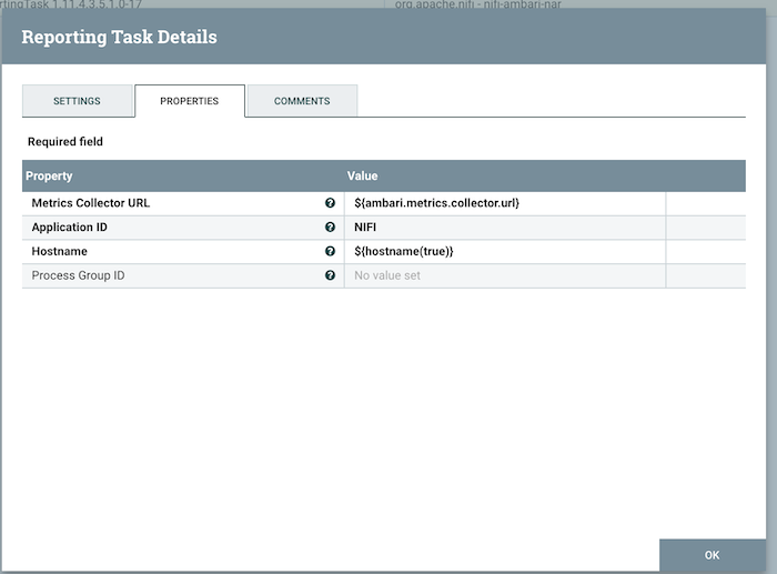

Issue:
The default Ambari reporting task in NiFi is not configured correctly and the NiFi metrics are not properly displayed in Ambari even though there is no reported error.
Workaround:
In the reporting task configuration, change the Application ID property to an uppercase value: NIFI. For example:
