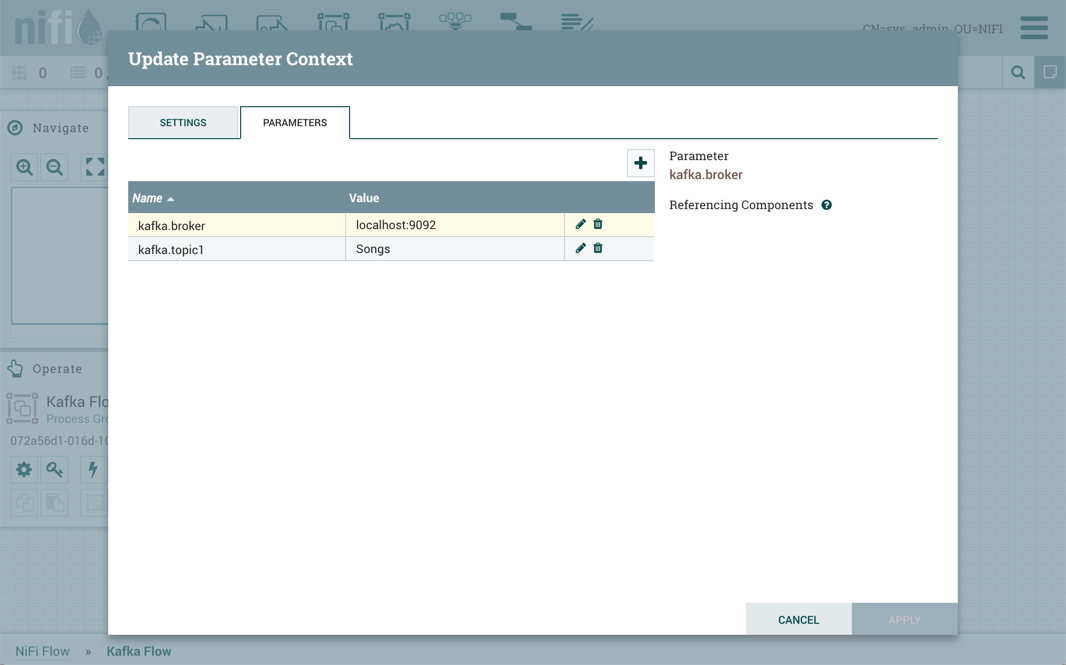

Parameters can be easily referenced or created as you configure the components in your
flow. For example, assume a process group has the Parameter Context "Kafka Settings"
assigned to it. "Kafka Settings" contains the parameters kafka.broker
and kafka.topic1

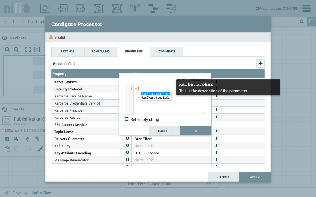

To reference kafka.broker
as the value for the "Kafka Brokers" property
in the PublishKafka processor, clear the default value and begin a new entry with the
start delimiter #{
. Next use the keystroke
control+space
to show the list of available parameters:

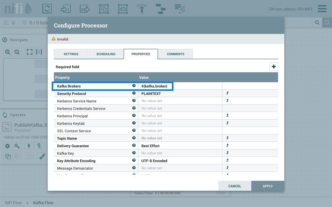

Select kafka.broker
and complete the entry with a closing curly brace

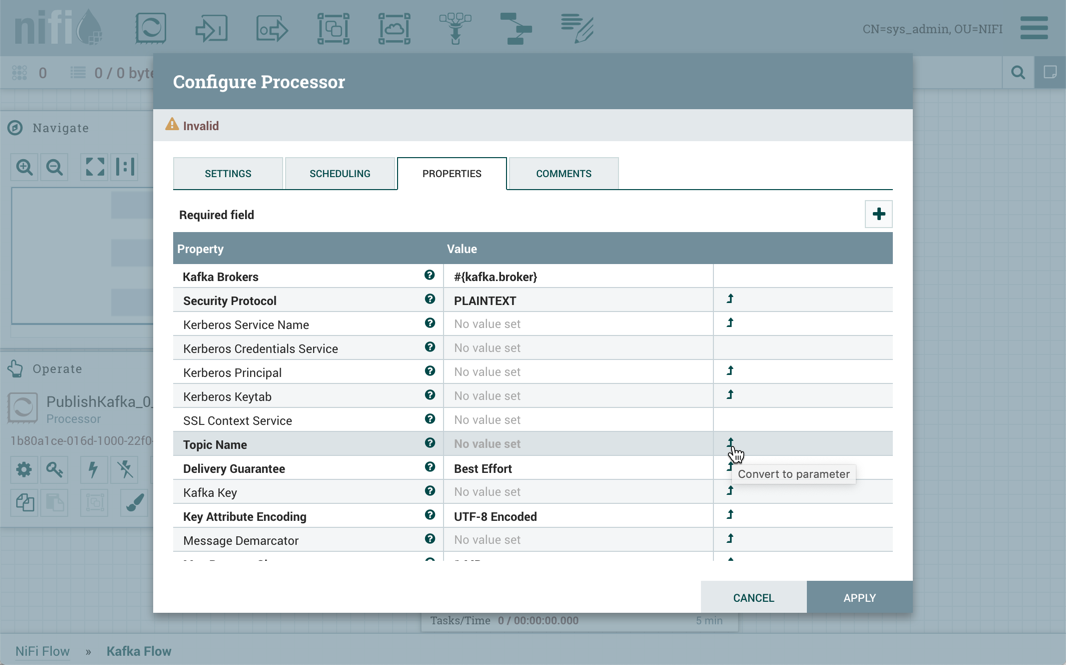

Parameters can also be created on the fly. For example, to create a parameter for the
"Topic Name" property, select the "Convert to Parameter" icon () in that property's row. This icon will
only be available if the user has appropriate permissions to modify the Parameter
Context (see Accessing Parameters for more information).
The Add Parameter dialog will open. Configure the new parameter as desired.
Select "Apply". The process group's Parameter Context will be updated and the new parameter will be referenced by the property with the proper syntax applied automatically.

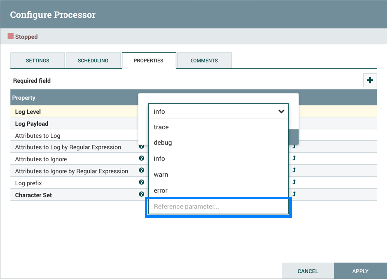

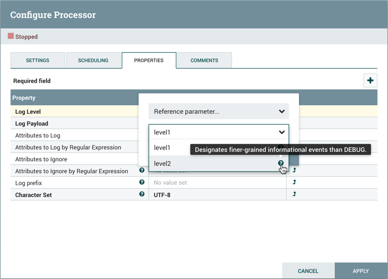

Properties values that are selectable can also reference parameters. In addition to applying the "Convert to Parameter" method described earlier, the option "Reference parameter.." is available in the value drop-down menu.
Selecting "Reference parameter…" will display a drop-down list of available parameters, determined by the parameter context assigned to the component's process group and the user's access policies.
Hovering over the question mark icon () displays
the parameter's description.
