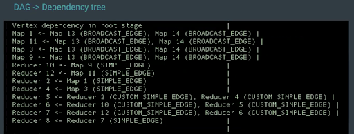

- Broadcast: sends the same data to every node
- Simple edge: sorts the data and sends it to the reducer
- Custom simple edge: sends data without sorting it

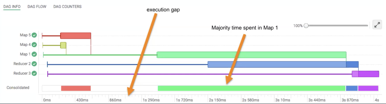

Next, check the Timeline section. It provides a break-up of the time taken to compile and parse the query, and build, submit, and run the DAG. This helps you to analyze query wait times. You can then go to the DAG INFO section to see which map or reducer has a dependency on other vertices and is consuming more time, and in turn resources.
For example, in the following image, Map 1 consumes maximum time. Reducer 2 waits for an input from Map 1, and Reducer 3 depends on Reducer 2 for input:
The vertical lines connecting two vertices denote the dependency of one vertex on another. The lightly shaded part of the horizontal bar indicates that a vertex is waiting for an input from the other vertex. The darker part of the bar indicates the actual execution time for that task. The vertical lines indicate the time when the vertex initialized, the time when the vertex started, the time when the first task started, the time when the last task completed, and the time when the vertex finished its execution. When you mouseover the vertical line, the bubble displays the stage of the vertex execution and provides a timestamp.
If you fix the white space (the execution gap) on the Consolidated bar, you can optimize this query to complete faster.
