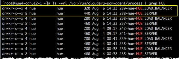

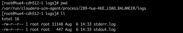

Cloudera Manager logs the start and stop of each supervised Hue process in standard
stream logs (stdout.log, stderr.log
ls -vrl /var/run/cloudera-scm-agent/process | grep HUE
It writes to a nested logs directory for each running instance:
Configuration errors are written here because they prevent Hue servers and load balancers from starting properly.

# Hue Server Process Directory
cd /var/run/cloudera-scm-agent/process/`ls -valrt /var/run/cloudera-scm-agent/process | grep HUE_SERVER | tail -1 | awk '{print $9}'`
cat supervisor.conf
