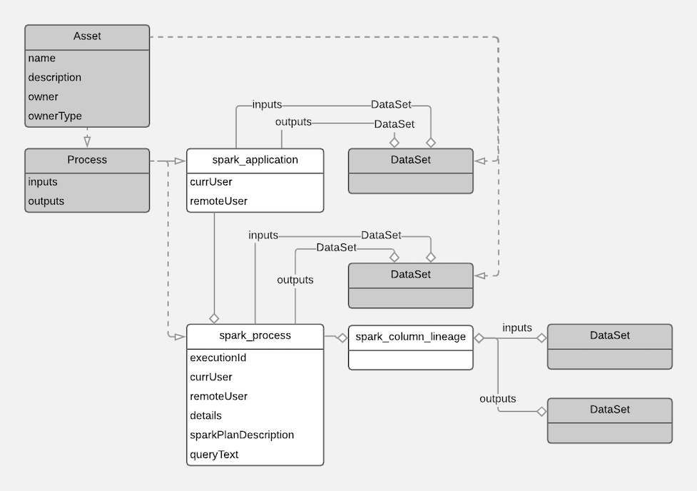

Spark entities created in Apache Atlas
Each Spark entity in Atlas includes detailed metadata collected from Spark.
The following diagrams show a summary of the entities created in Atlas for Spark operations. The data assets that Spark operations act upon are collected through HMS. The supertypes that contribute attributes to the entity types are shaded.
The metadata collected for each entity type is as follows:

Spark Column Lineage
At this time, column lineages are not represented for Spark processes.
| Identifier | Example Content |
| typeName | spark_column_lineage |
| name | Reserved for future use. |
| qualifiedName | Reserved for future use. |
| Relationship: Process | Name of the spark_process entity that
produced this lineage.
spark_process_column_lineages |
| Relationship: inputs | Reserved for future use. |
| Relationship: ouptuts | Reserved for future use. |
