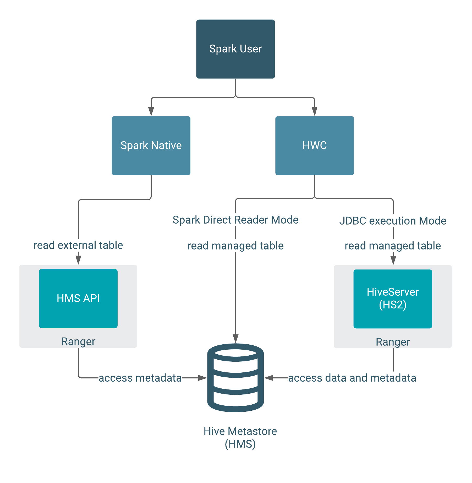

- Spark Direct Reader mode: Connects to Hive Metastore (HMS)
- JDBC execution mode: Connects to HiveServer (HS2)
The read execution mode determines the type of query authorization for reads. Ranger authorizes access to Hive tables from Spark through HiveServer (HS2) or the Hive metastore API (HMS API).

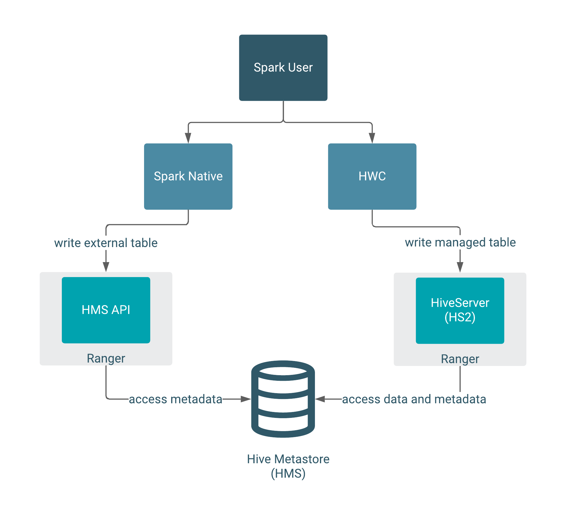

To write ACID managed tables from Spark to Hive, use HWC. To write external tables from Spark to Hive, use native Spark.
The following diagram shows the typical read authorization process:
The following diagram shows the typical write authorization process:
You need to use HWC to read or write managed tables from Spark. Spark Direct Reader mode does not support writing to managed tables. Managed table queries go through HiveServer, which is integrated with Ranger. External table queries go through the HMS API, which is also integrated with Ranger.
In Spark Direct Reader mode, SparkSQL queries read managed table metadata directly from the HMS, but only if you have permission to access files on the file system.
If you do not use HWC, the Hive metastore (HMS) API, integrated with Ranger, authorizes external table access. HMS API-Ranger integration enforces the Ranger Hive ACL in this case. When you use HWC, queries such as DROP TABLE affect file system data as well as metadata in HMS.
