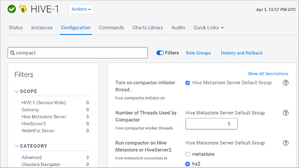

The following properties must be set in Hive metastore (Hive-1) and Hive on Tez
services as follows:
hive.compactor.initiator.on = true (default)
hive.compactor.worker.threads = <a value greater than 0>
(default and recommended value = 5)
hive.metastore.runworker.in = hs2 (default)
Tables or partitions you are compacting must be full ACID or insert-only ACID
tables.
In Cloudera Manager, select the Hive metastore service: .
Search for
compact.
Check that Turn on Compactor Initiator Thread
hive.compactor.initiator.on), Number of Threads Used by
Compactor (hive.compactor.worker.threads), and Run Compactor on
Hive Metastore or HiveServer2 (hive.metastore.runworker.in) are
set to the values shown above.
Save the changes.

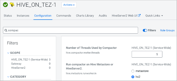

Search for
compact.
Check that the Number of Threads Used by Compactor
hive.compactor.worker.threads), and Run compactor on Hive
Metastore or HiveServer2 (hive.metastore.runworker.in) is set
to hs2.
Save the changes and restart the Hive on Tez and Hive (HIVE-1) metastore
services at an appropriate time.
