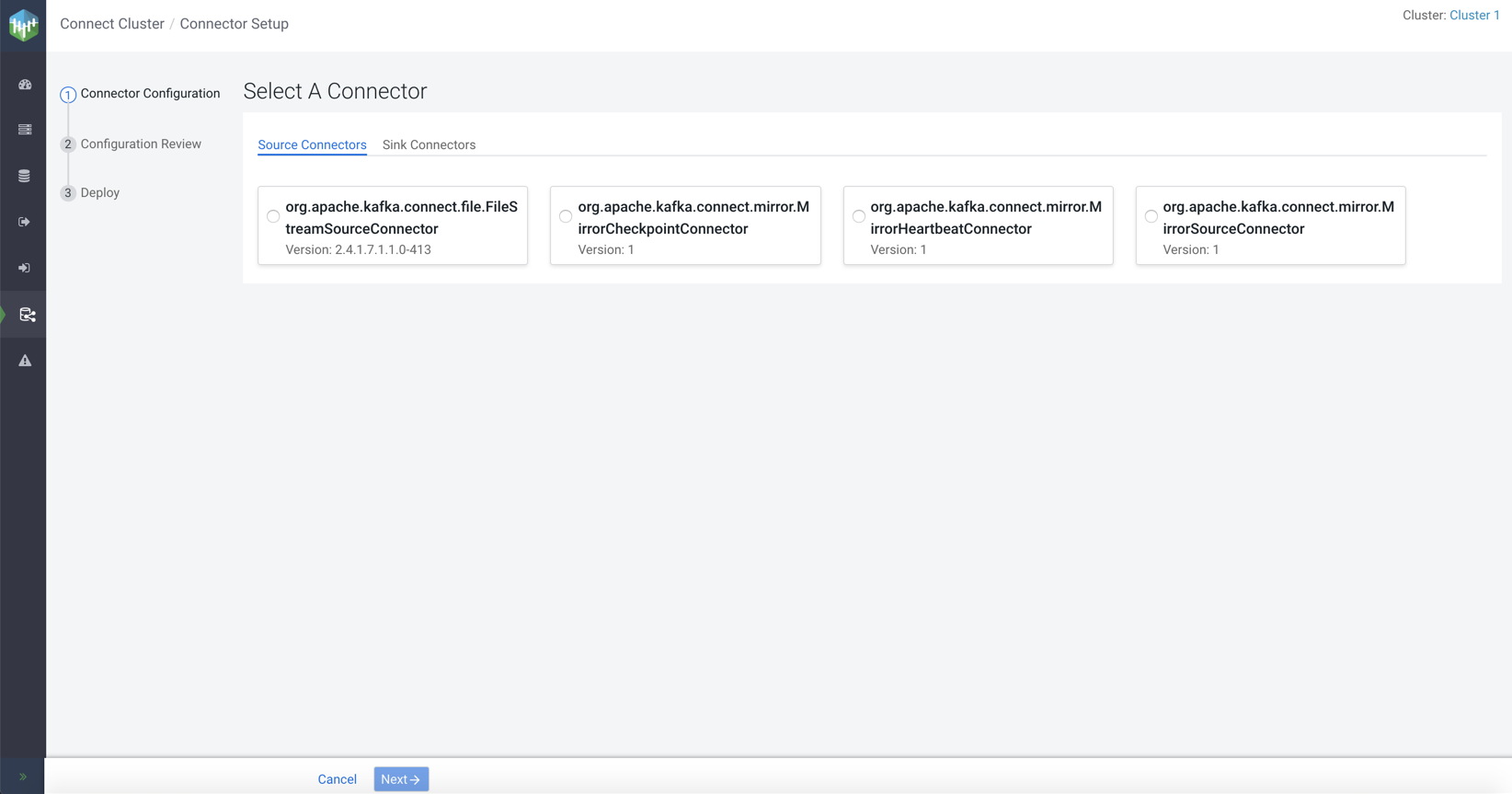

Click the New Connector option in the upper right corner
of the
Connect Clusterpage.The
Select A Connectorscreen appears.
Go to Source Connectors or Sink
Connectors tab based on your requirement.
Both the tabs show the list of available connectors.

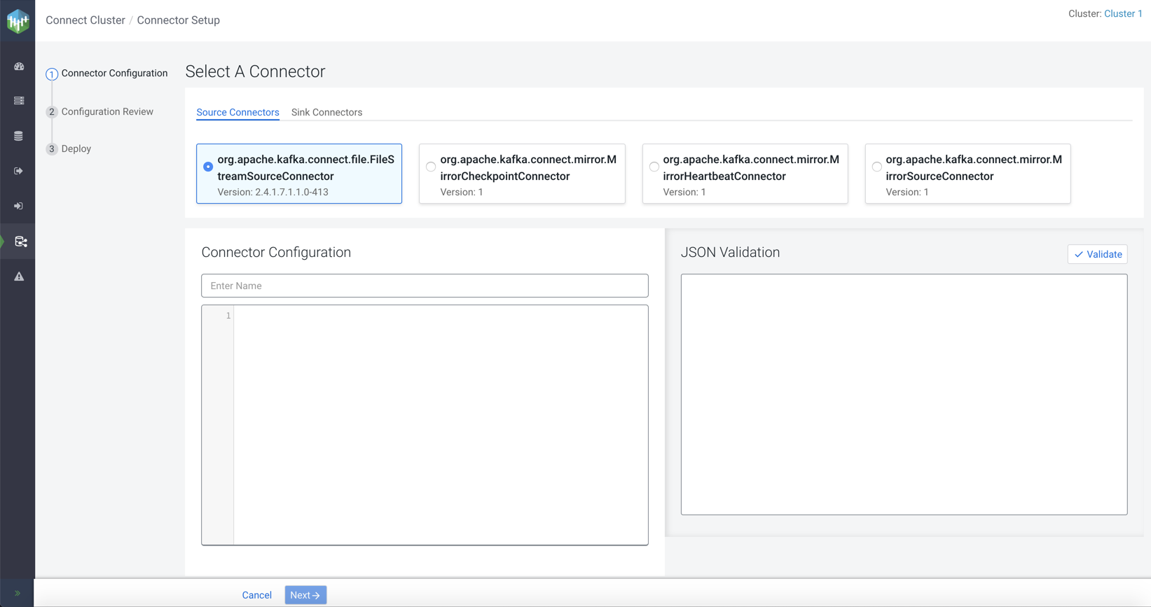

Select a connector.
The configuration options appear.

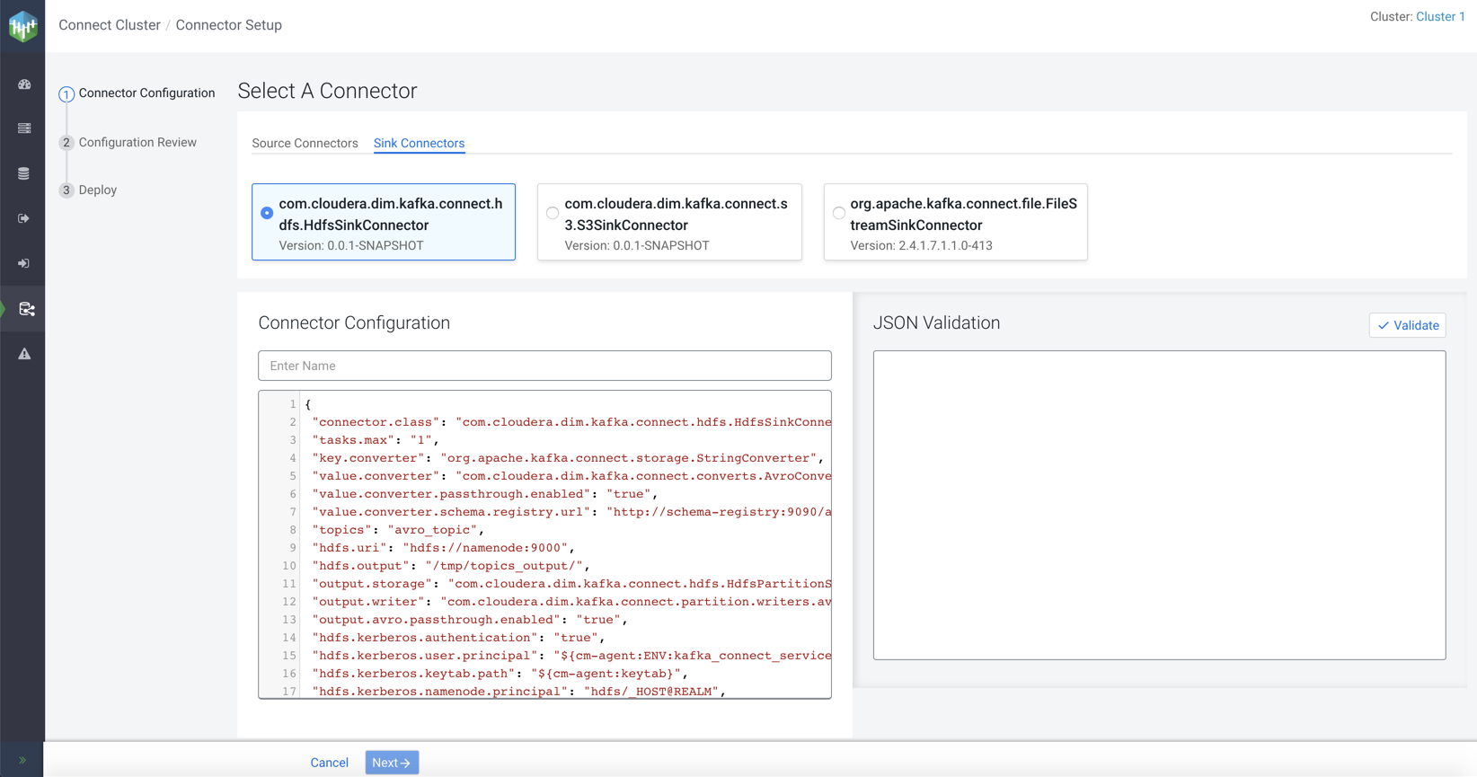

Enter a name for the connector in the Connector
Configuration section.
A sample configuration appears for some connectors.
The following image shows the sample configuration for HDFS sink connector:
Optional. Modify the sample configuration as per your requirement.
You can refer to environment variables by using a syntax similar to
Also, as shown in the sample configuration, you can refer to the keytab path by specifying${cm-agent:ENV:ENVIRONMENT_VARIABLE_NAME}. You should replace theENVIRONMENT_VARIABLE_NAMEwith the exact environment variable name.${cm-agent:keytab}. - Click Validate.

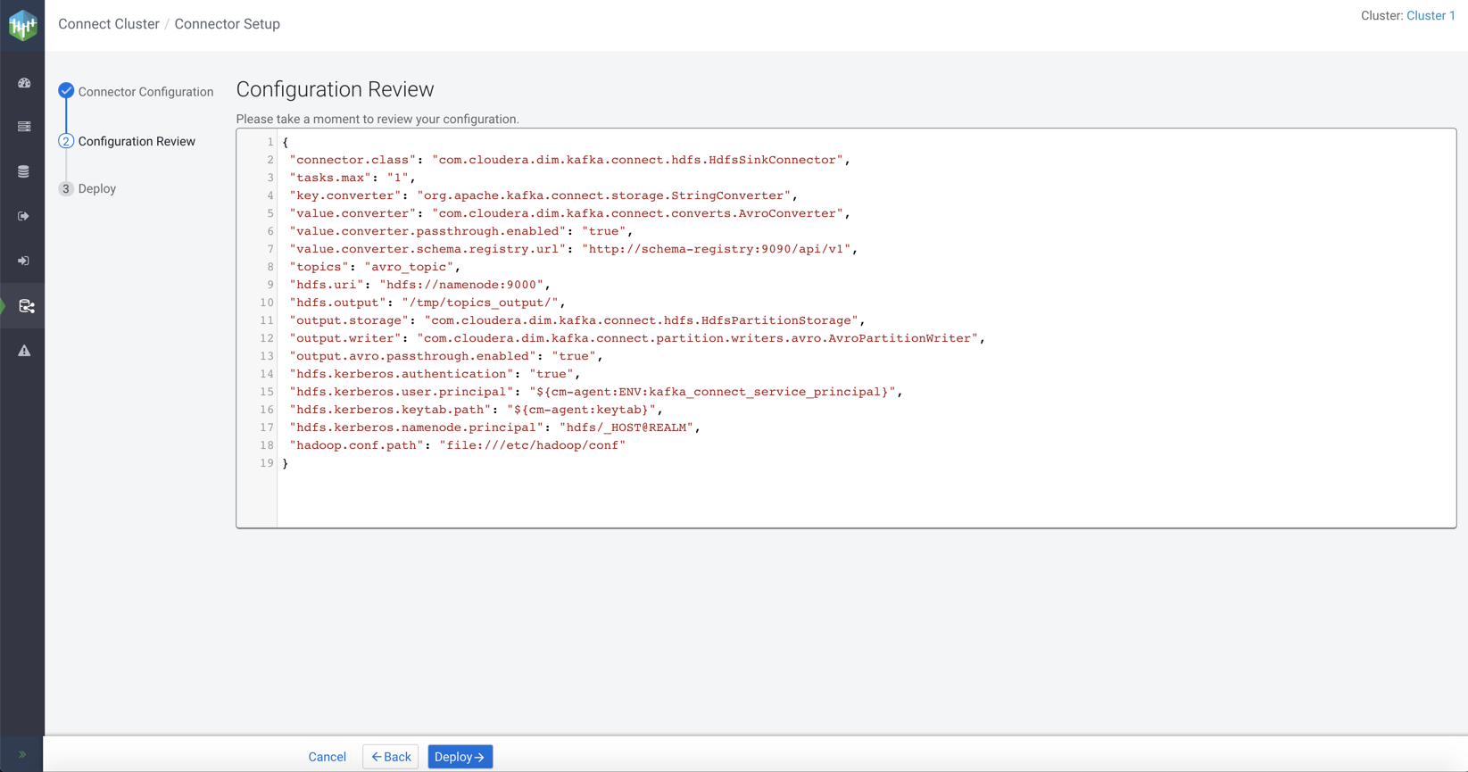

Click Next.
The
Configuration Reviewpage appears.

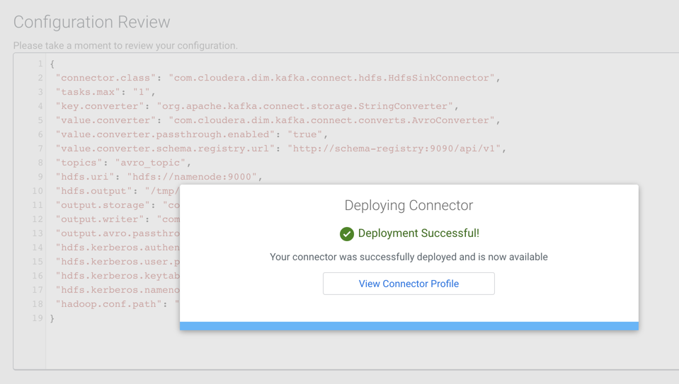

Review your connector configuration and click
Deploy.
The
Deploying Connectordialog appears.
Click View Connector Profile.
The
Connector Profilepage appears where you can view your connector details.
