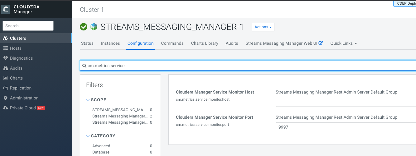

- CDPD-17361: Consumer Group metrics does not appear in SMM
- SMM emits consumer metrics to Cloudera Manager and reads
the consumer metrics back from Cloudera Manager. For SMM to work correctly, you
must configure the Cloudera Manager Service Monitor Host
property. This property is also know as
