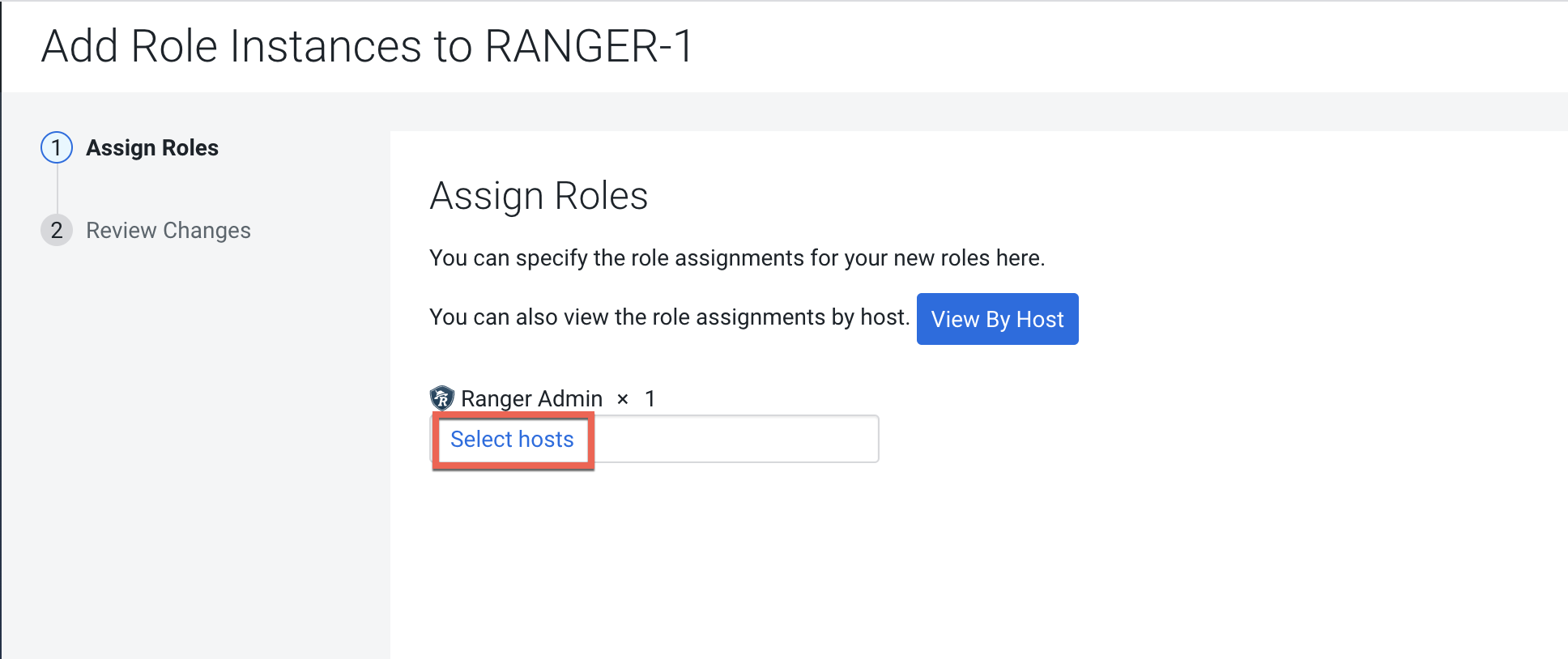

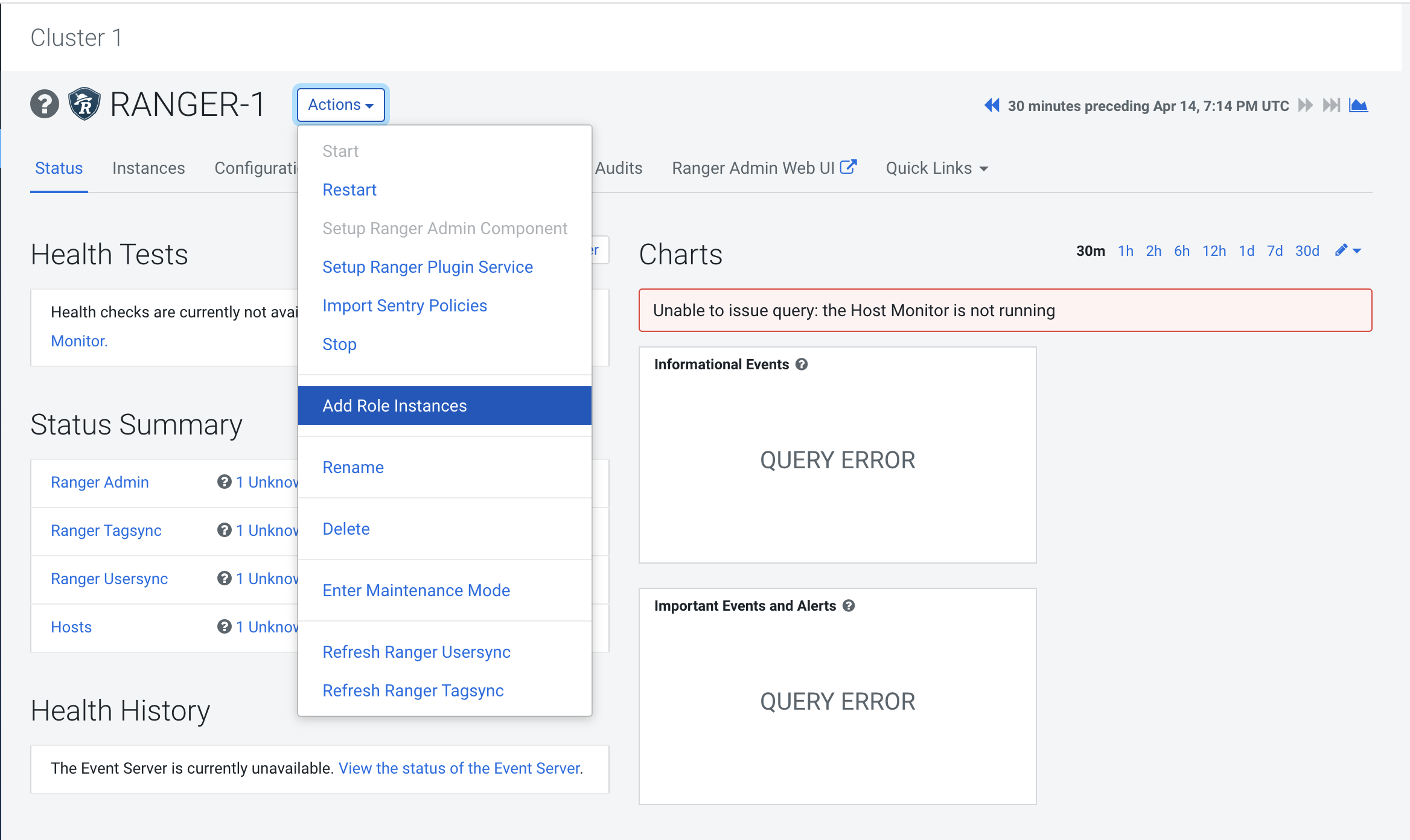

In Cloudera Manager, select Ranger, then select Actions > Add Role
Instances.
On the Add Role Instances page, click Select hosts.

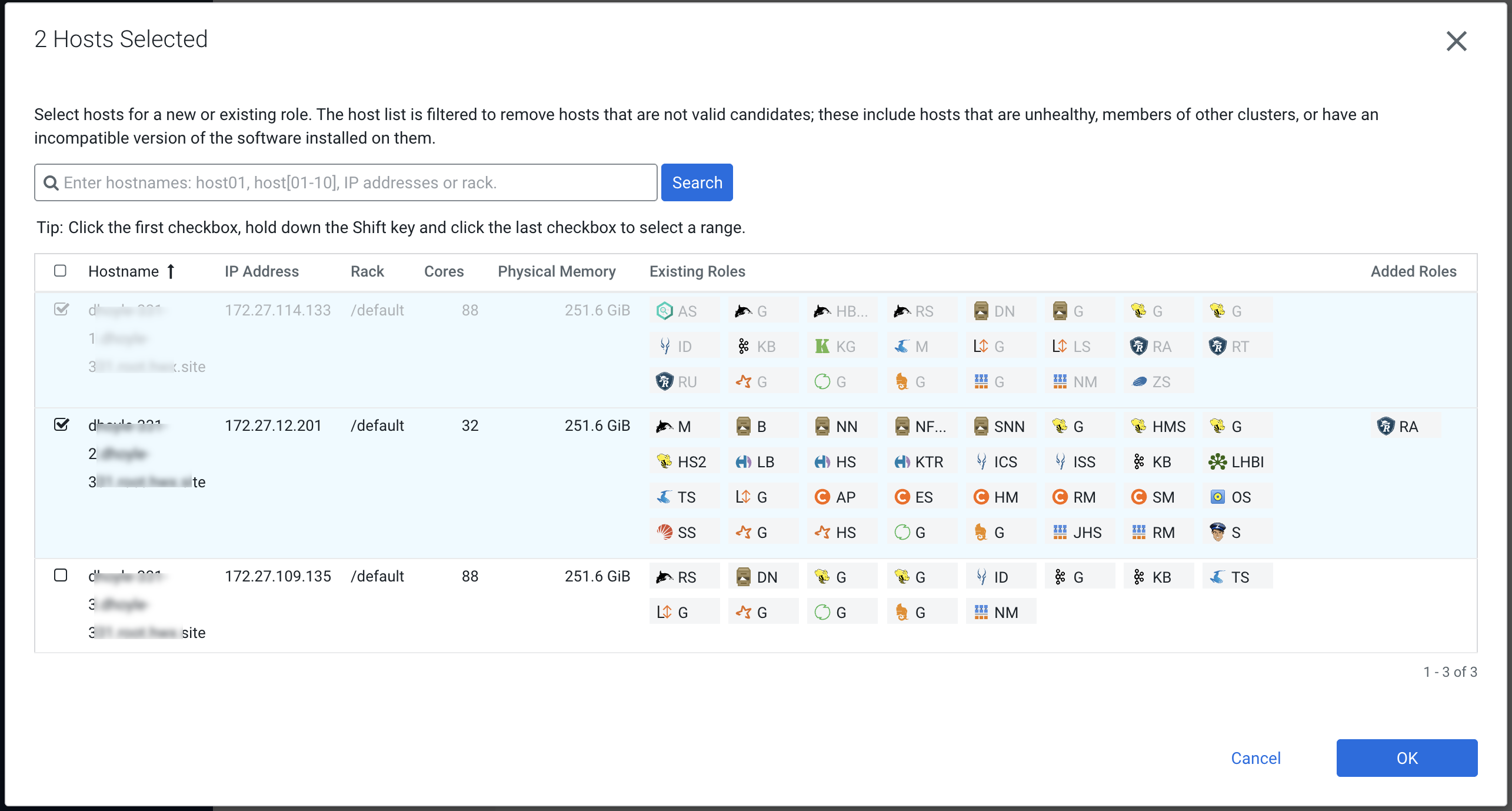

On the selected hosts page, the primary Ranger Admin host is selected by default.
Select your configured backup Ranger host (

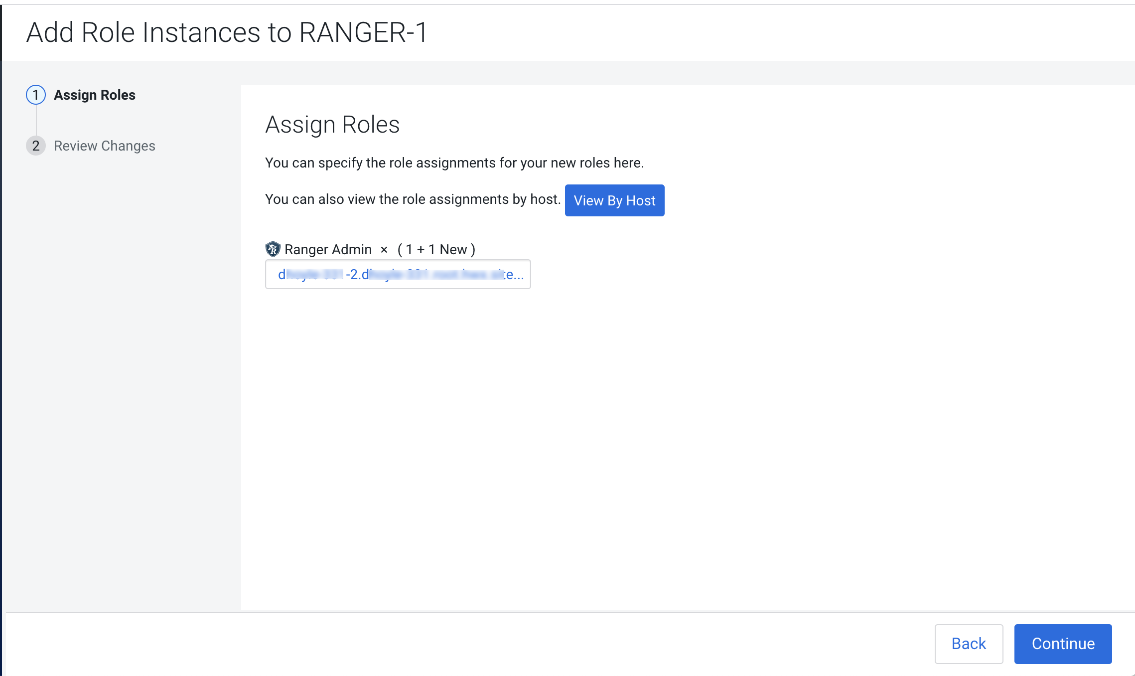

ranger-host2-fqdn). A Ranger Admin (RA) icon appears in the Added Roles column for the selected backup host. Click OK to continue.
The Add Role Instances page is redisplayed with the new backup host. Click
Continue.

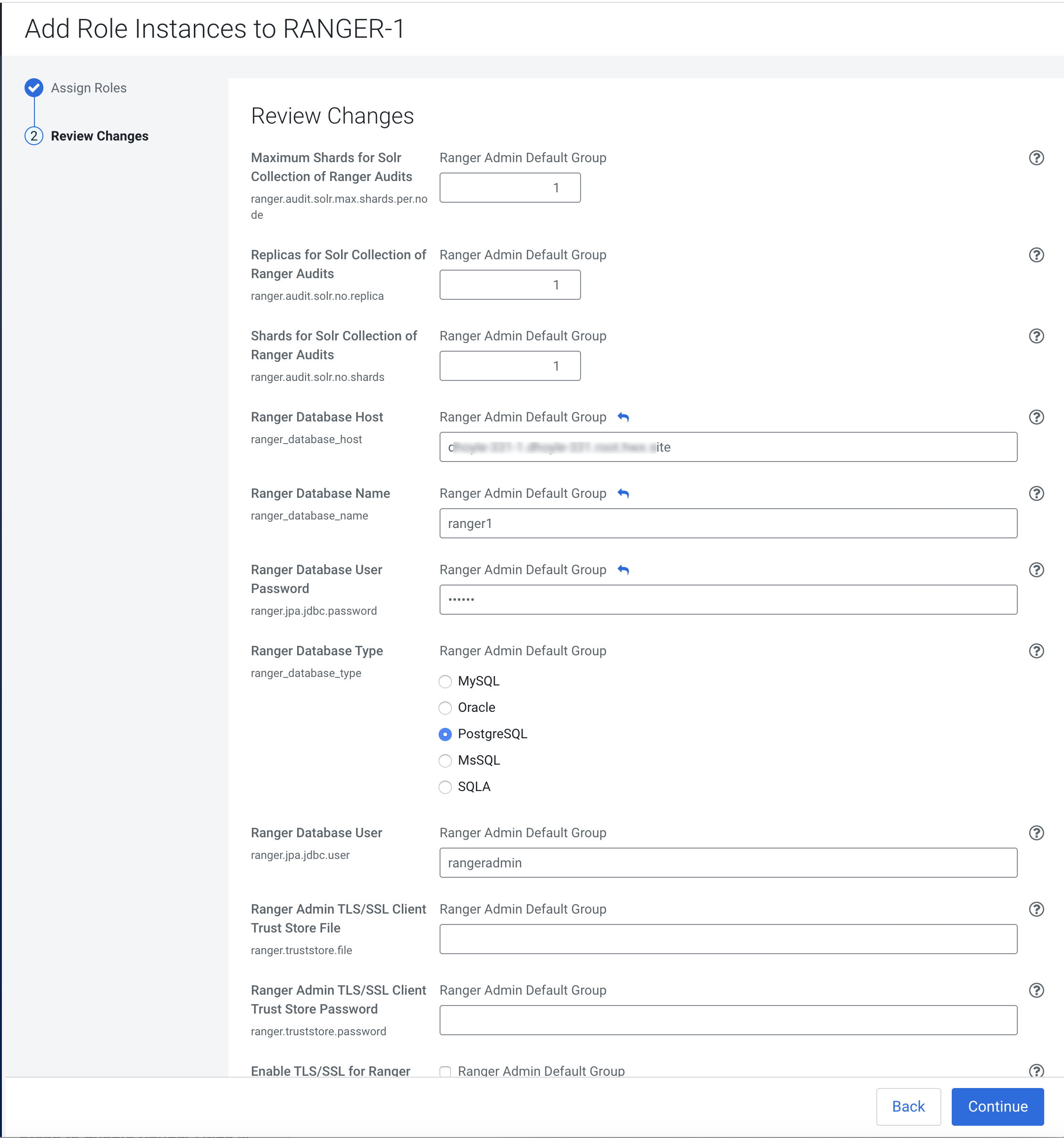

Review the settings on the Review Changes page, then click Continue.

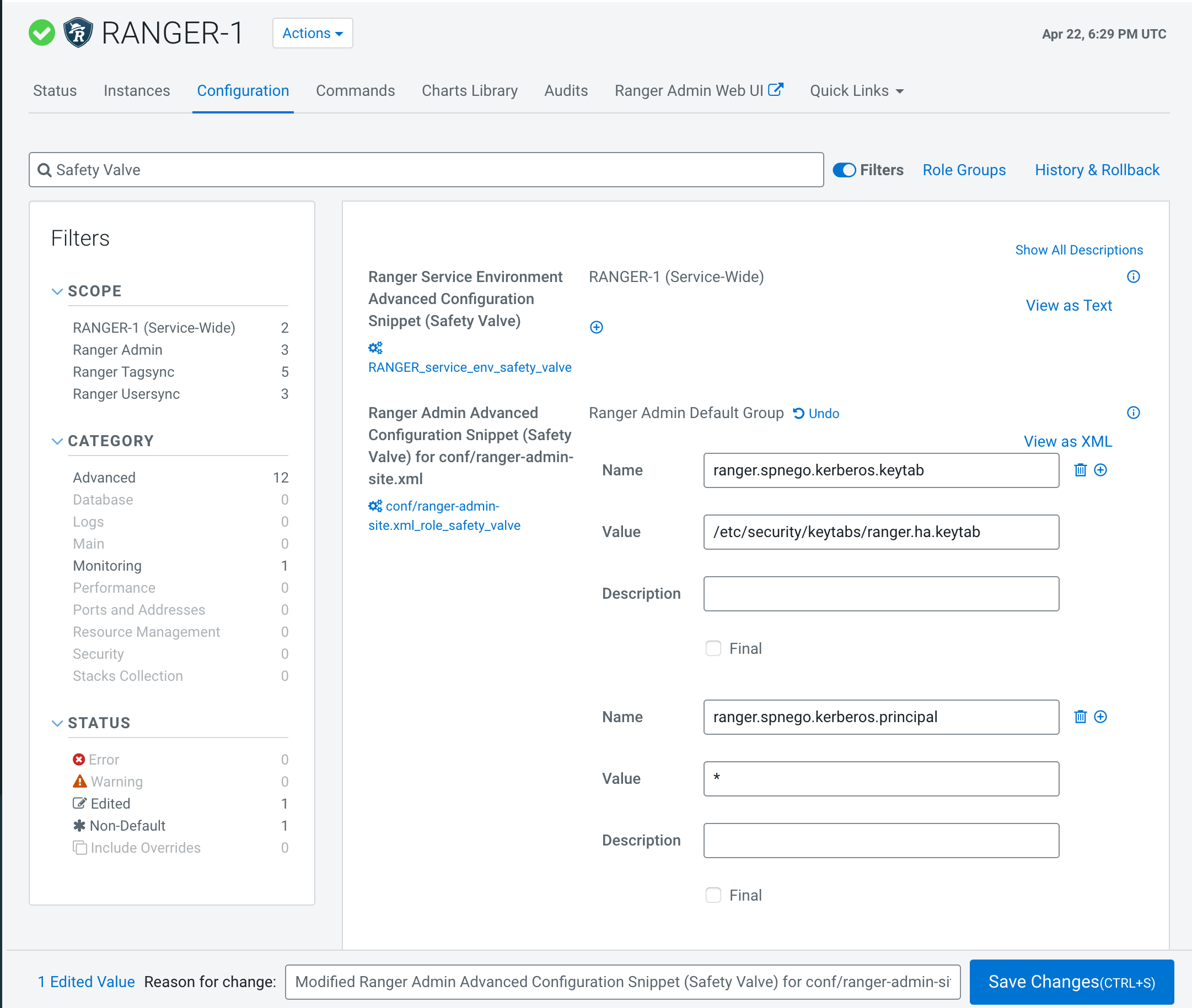

Update the following
ranger-admin-site.xmlconfiguration settings using the Safety Valve.ranger.spnego.kerberos.keytab=/etc/security/keytabs/ranger.ha.keytab ranger.spnego.kerberos.principal=*

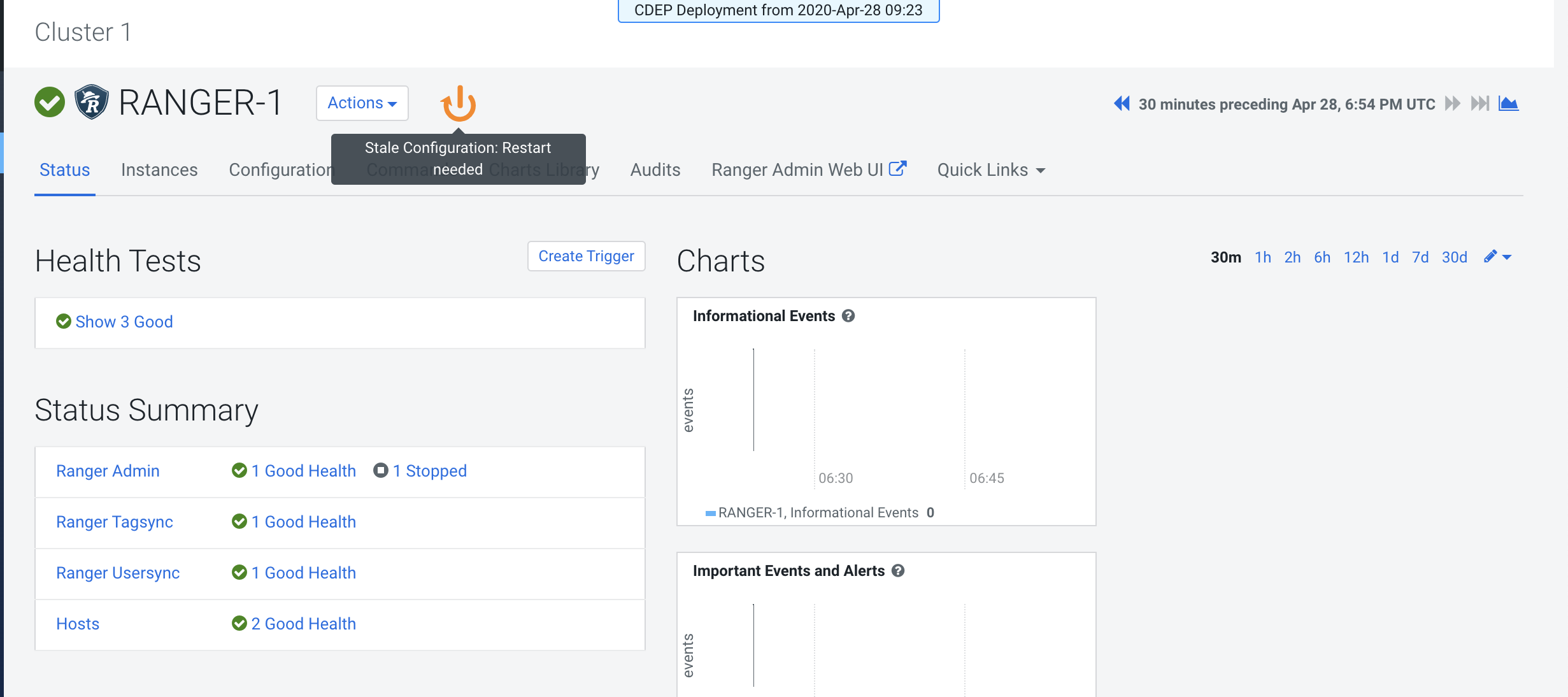

Restart all cluster services that require a restart, then click Finish.

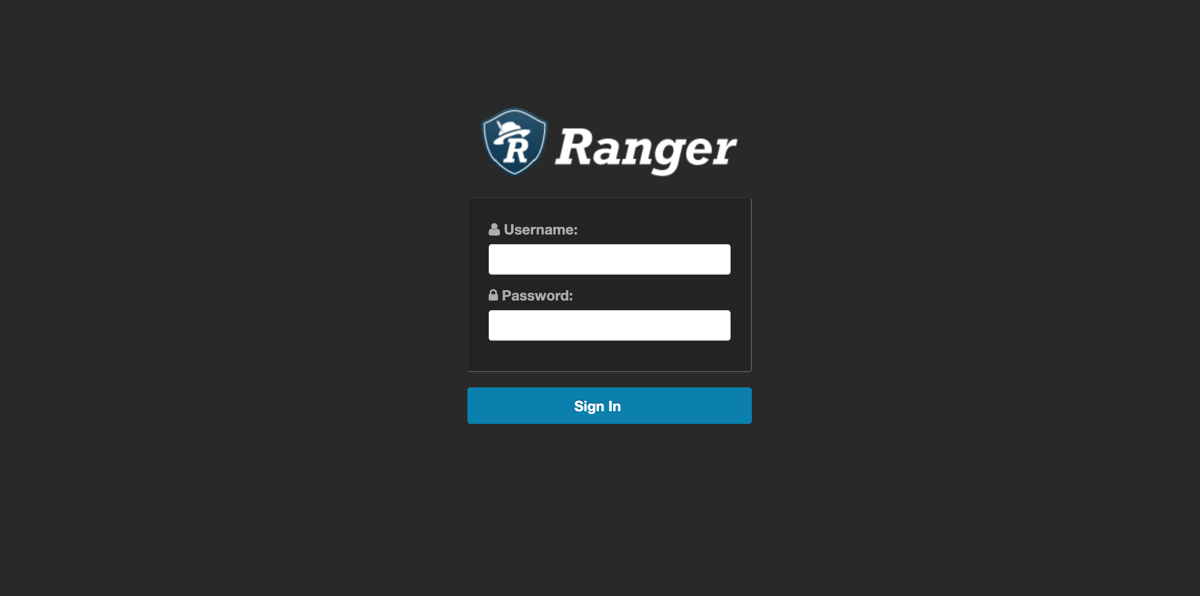

Use a browser to check the load-balancer host URL (with port). You should see the
Ranger Admin page.
