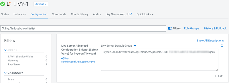

- In Cloudera Manager, go to .
- Click the Configuration tab and search for the "Livy Server Advanced Configuration Snippet (Safety Valve) for livy-conf/livy.conf" property.
- Add the /opt/cloudera/parcels/CDH-<version>/jars folder to
the
livy.file.local-dir-whitelistproperty in thelivy.conffile.
- Save the changes and restart the Livy service.
- Log in to the Zeppelin Server Web UI and restart the Livy interpreter.
