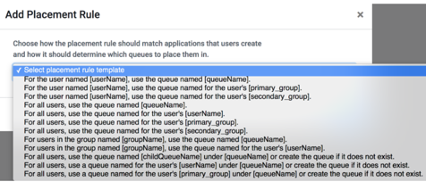

Click +Add. The Add Placement Rule dialog box is displayed.
Select a placement rule template from the drop-down list.
Add the rule to match applications with the queues using the Add Placement Rule dialog box.
The static rules use the existing queues and dynamic rules create a queue if it does not exist. The dynamic rule templates end with the phrase
or create the queue if it does not exist. -
