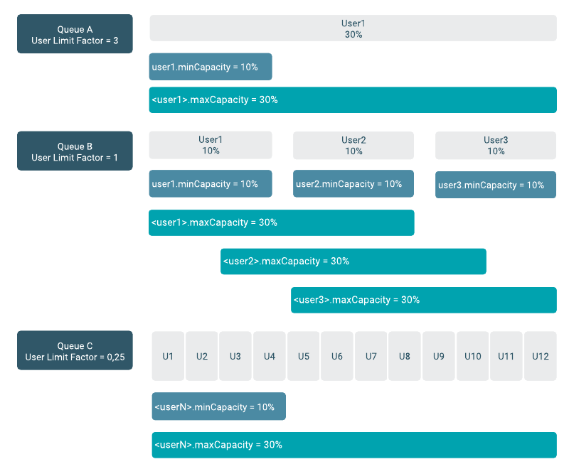

Capacity Scheduler’s leaf queues can also use the user-limit-factor property to control user resource allocations. This property denotes the fraction of queue capacity that any single user can consume up to a maximum value, regardless of whether or not there are idle resources in the cluster.
To configure the maximum limit (user-limit-factor) based on this example, perform the following:
- In Cloudera Manager, select Clusters > YARN Queue Manager UI service. A graphical queue hierarchy is displayed in the Overview tab.
- Click on the three vertical dots on the queue you want to set limit and select View/Edit Queue Properties option.
- In the Queue Properties dialog-box, enter 1 in the User Limit Factor text box.
- Click Save.
The default value of 1 means that any single user in the queue can, at the most, only occupy only the queue’s configured capacity. This prevents users in a single queue from monopolizing resources across all queues in a cluster. Setting the value to 2 restricts the queue's users to twice the queue’s configured capacity. Setting it to a value of 0.5 restricts any user from using resources beyond half of the queue capacity.
