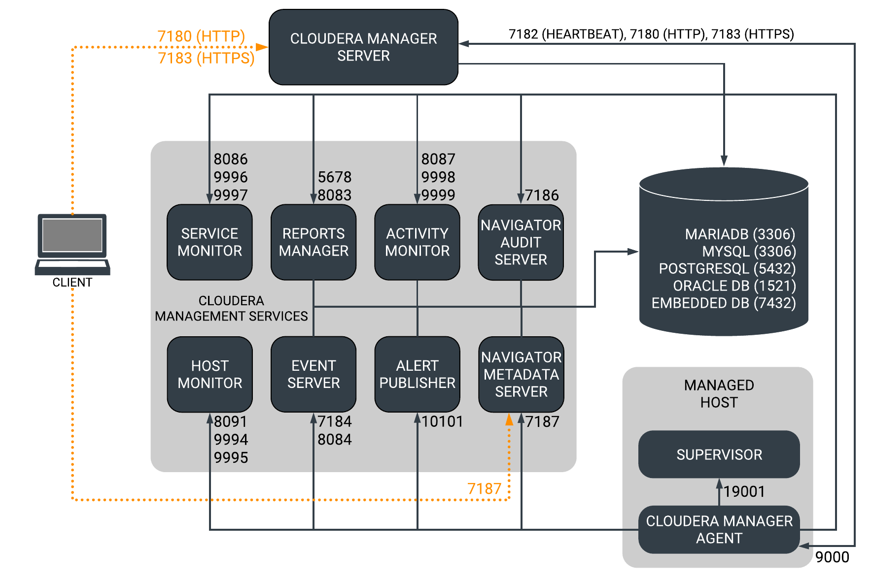

Ports Used by Cloudera Manager
The diagrams and tables below provide an overview of some of the ports used by Cloudera Manager and Cloudera Management Service roles.

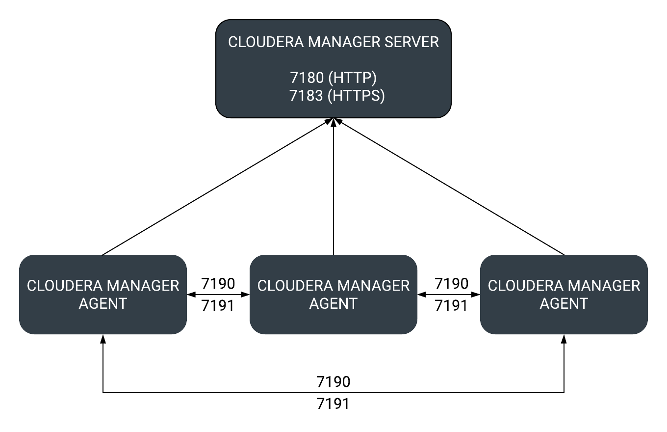

When peer-to-peer distribution is enabled for parcels, the Cloudera Manager Agent can obtain the parcel from the Cloudera Manager Server or from other agents, as follows:
For further details, see the following tables. All ports listed are TCP.
In the following tables, Internal means that the port is used only for communication among the components; External means that the port can be used for either internal or external communication.

| Peer-to-peer parcel distribution | 7190, 7191 | Used to distribute parcels to cluster hosts during installation and upgrade operations. | ||
