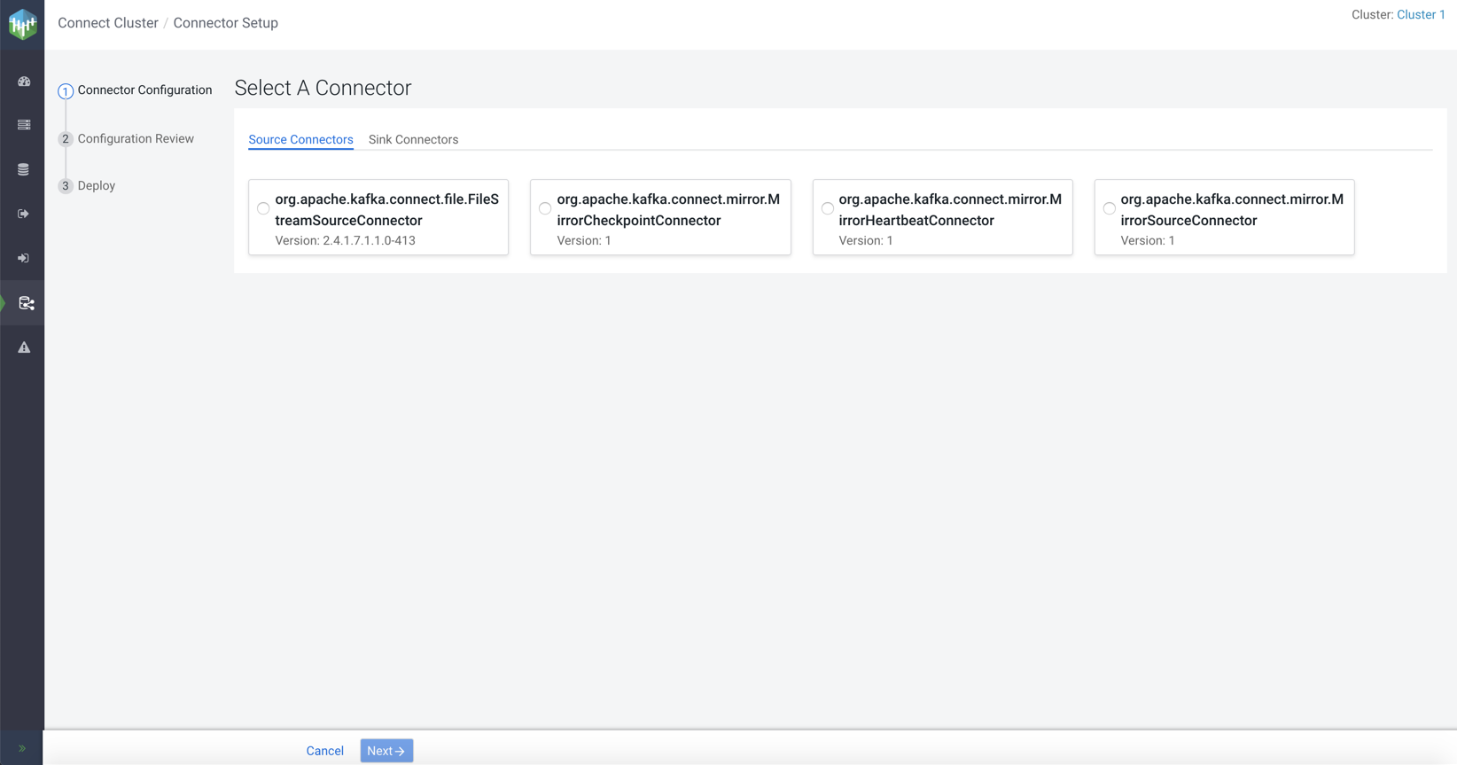

Click the New Connector option in the upper right corner
of the
Connect Cluster
page.The
Select A Connector
screen appears.

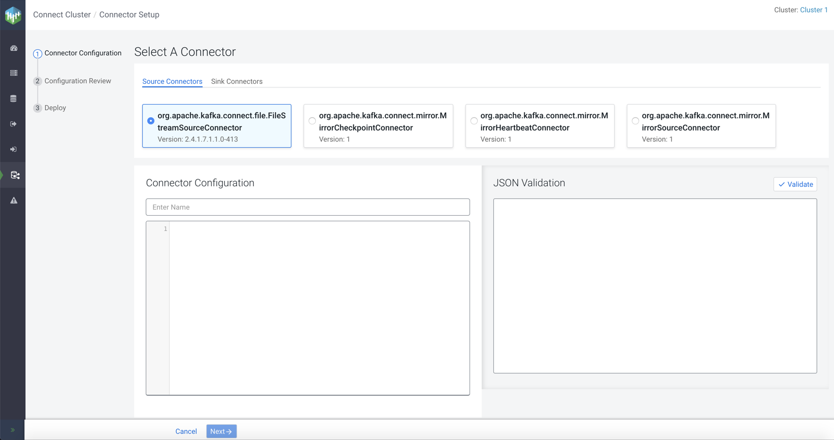

Go to Source Connectors or Sink
Connectors tab based on your requirement.
Both the tabs show the list of available connectors.
Select a connector.
The configuration options appear.

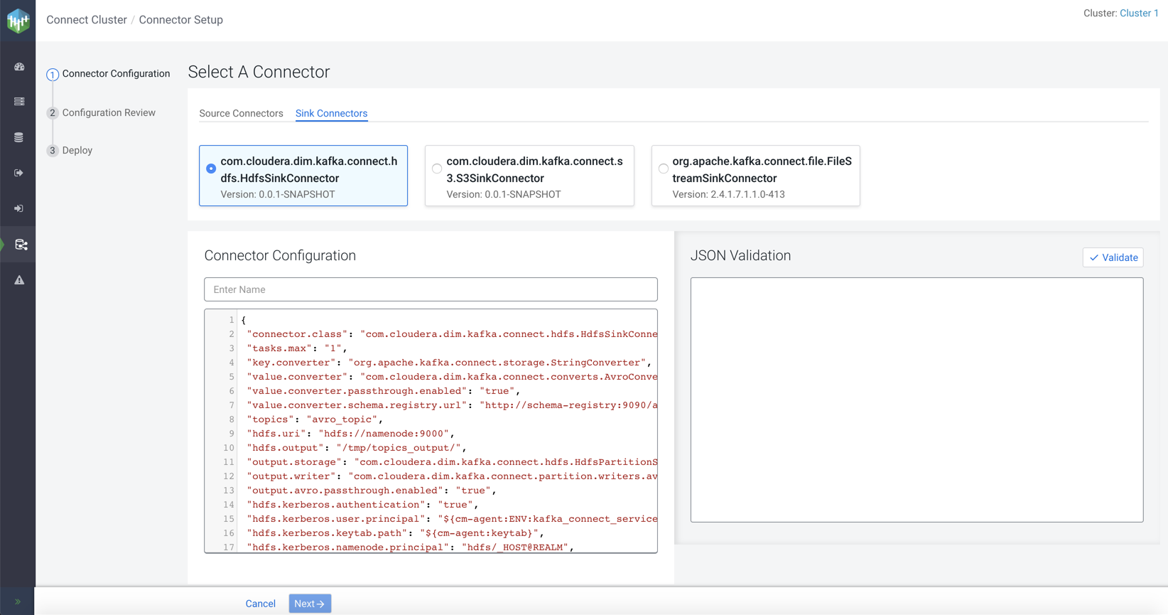

Enter a name for the connector in the Connector
Configuration section.
A sample configuration appears for some connectors.
The following image shows the sample configuration for HDFS sink connector:
Optional. Modify the sample configuration as per your requirement.

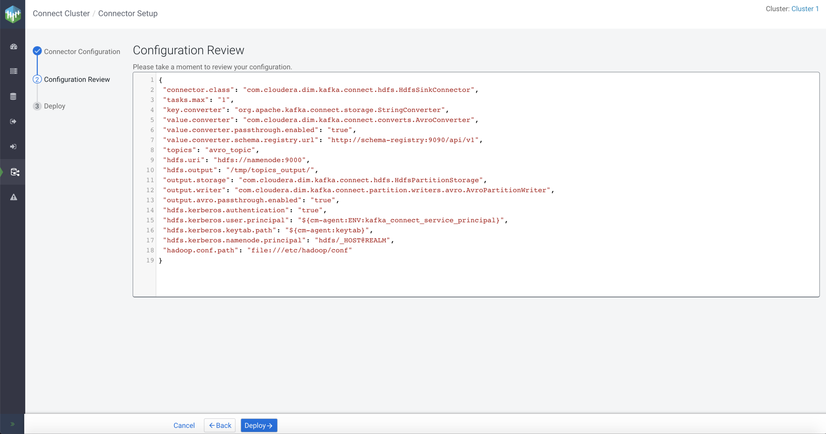

The
Configuration Review
page appears.

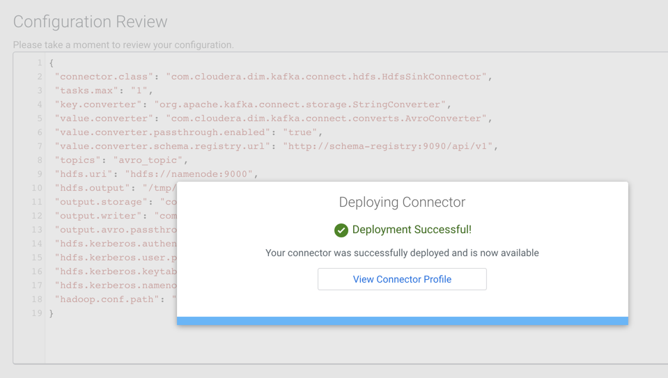

Review your connector configuration and click
Deploy.
The
Deploying Connector
dialog appears.
Click View Connector Profile.
The
Connector Profile
page appears where you can view your connector details.
