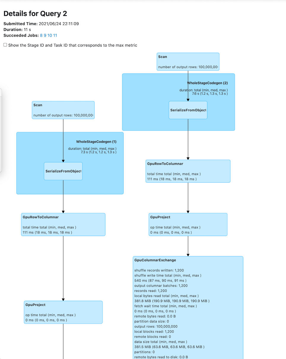

- Run a job in spark3-shell.For example:
scala> val df = sc.makeRDD(1 to 100000000, 6).toDF df: org.apache.spark.sql.DataFrame = [value: int] scala>val df2 = sc.makeRDD(1 to 100000000, 6).toDF df2: org.apache.spark.sql.DataFrame = [value: int] scala> df.select($"value" as "a").join(df2select($"value" as "b"), $"a" === $"b").count res0: Long = 100000000 - You can verify that the job run used GPUs, by logging on to the Yarn UI v2 to review the
execution plan and the performance of your spark3-shell application:
Select the Applications tab then select your [spark3-shell application]. Select to see the execution plan.
