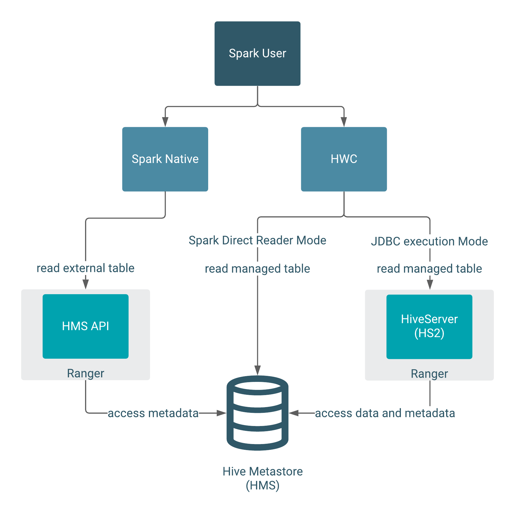

Ranger authorizes access to Hive tables from Spark through HiveServer (HS2), or the Hive metastore API (HMS API).

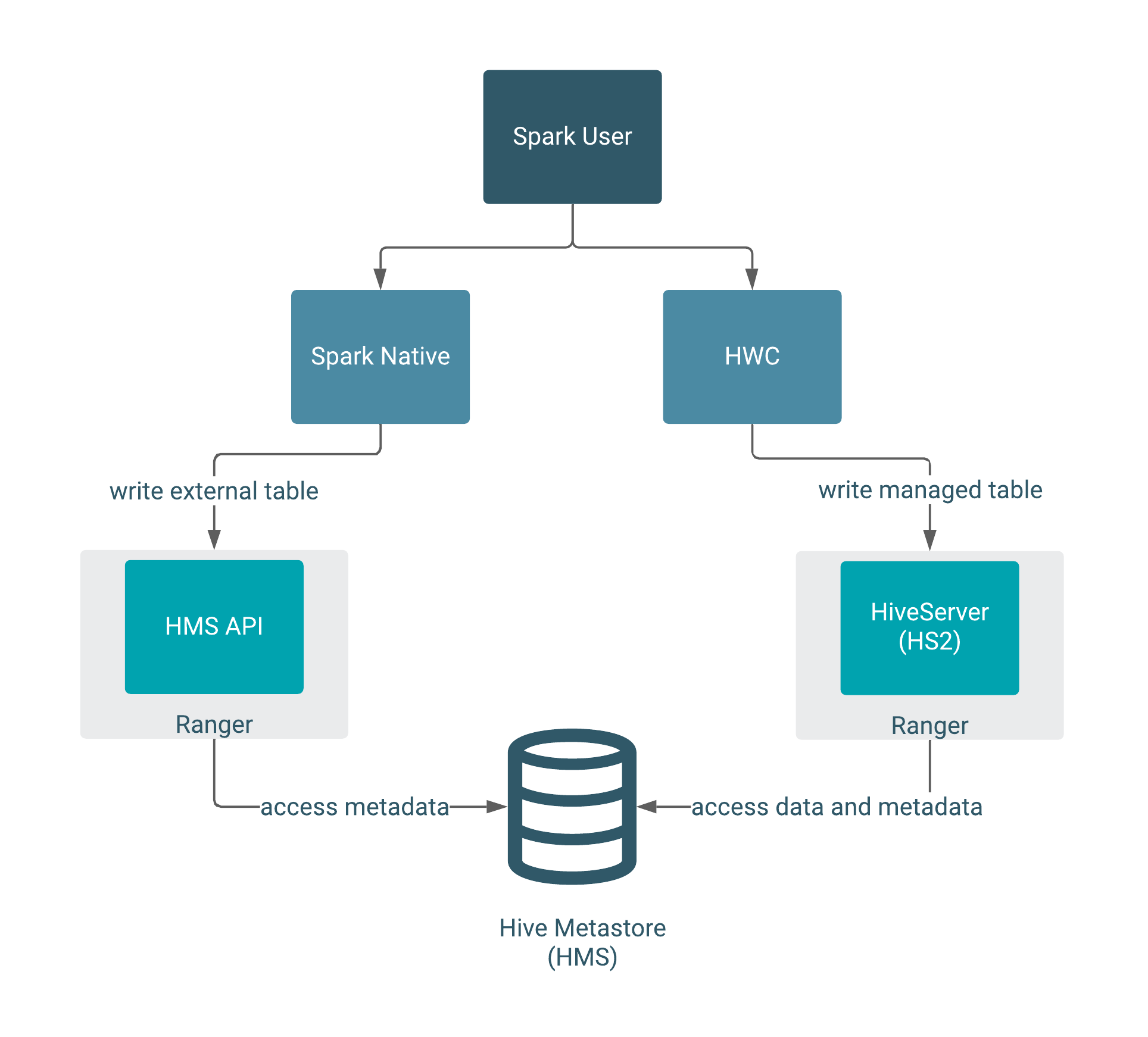

To write ACID managed tables from Spark to Hive, you must use HWC. To write external tables from Spark to Hive, you can use native Spark or HWC.
The following diagram shows the typical read authorization process:
The following diagram shows the typical write authorization process:
When writing, HWC always enforces authorization through HiveServer (HS2). Reading managed tables in JDBC mode enforces Ranger authorization, including fine-grained features, such as column mapping. In Direct Reader mode, the Ranger and HMS integration provides authorization.
External table queries go through the HMS API, which is also integrated with Ranger. If you do not use HWC, the Hive metastore (HMS) API, integrated with Ranger, authorizes external table access. HMS API-Ranger integration enforces the Ranger Hive ACL in this case. When you use HWC, queries such as DROP TABLE affect file system data as well as metadata in HMS.
Using the Direct Reader option, SparkSQL queries read managed table metadata directly from the HMS, but only if you have permission to access files on the file system. You cannot write to managed tables using the Direct Reader option.
