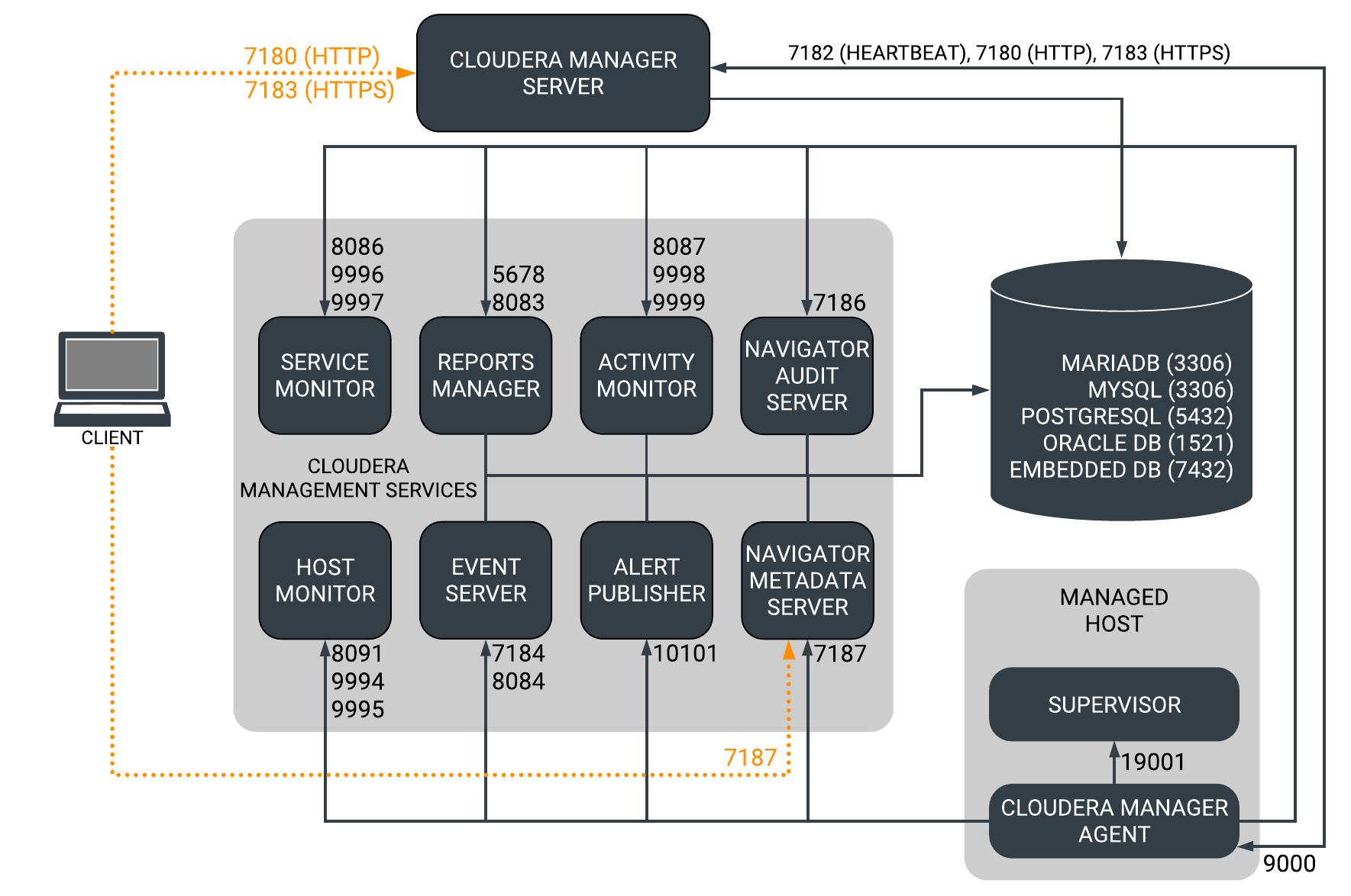

The diagrams and tables below provide an overview of some of the ports used by Cloudera Manager and Cloudera Management Service roles.

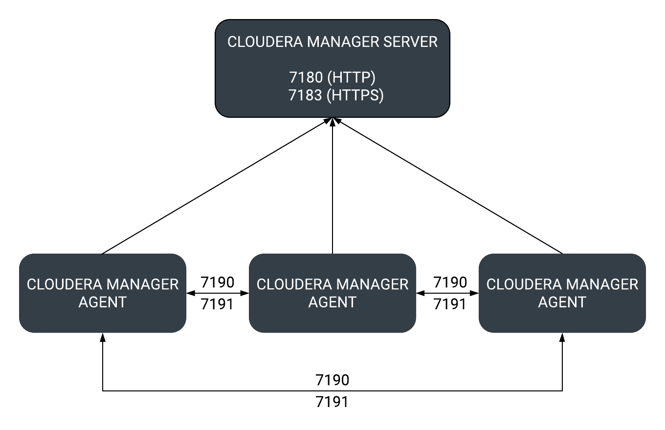

When peer-to-peer distribution is enabled for parcels, the Cloudera Manager Agent can obtain the parcel from the Cloudera Manager Server or from other agents, as follows:
For further details, see the following tables. All ports listed are TCP.
In the following tables, Internal means that the port is used only for communication among the components; External means that the port can be used for either internal or external communication.
| Component | Service | Port | Configuration | Description |
| Cloudera Manager Server | HTTP (Web UI) | 7180 | HTTP port used by the web console. | |
| HTTPS (Web UI) | 7183 | Port used by the web console if HTTPS is enabled. If enabled, port 7180 remains open, but redirects all requests to HTTPS on port 7183. | ||
| Cloudera Manager Agent | HTTP (Debug) | 9000 | /etc/cloudera-scm-agent/config.ini | |
| Backup and Disaster Recovery | HTTP (Web UI) | 7180 | Used for communication to peer (source) Cloudera Manager. | |
| HTTPS (Web UI) | 7183 | Used for communication to peer (source) Cloudera Manager when HTTPS is enabled. | ||
| HDFS NameNode | 8020 | HDFS and Hive/Impala replication: communication from destination HDFS and MapReduce hosts to source HDFS NameNode(s). Hive/Impala Replication: communication from source Hive hosts to destination HDFS NameNode(s). | ||
| HDFS DataNode | 9866 | HDFS and Hive/Impala replication: communication from destination HDFS and MapReduce hosts to source HDFS DataNode(s). Hive/Impala Replication: communication from source Hive hosts to destination HDFS DataNode(s). | ||
| Telemetry Publisher | HTTP | 10110 | The port where the Telemetry Publisher Server listens for requests | |
| Telemetry Publisher | HTTP (Debug) | 10111 | The port where Telemetry Publisher starts a debug web server. Set to -1 to disable debug server. |

| Peer-to-peer parcel distribution | 7190, 7191 | Used to distribute parcels to cluster hosts during installation and upgrade operations. | ||
