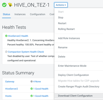

In Cloudera Manager (CM), click to go to the Hive on Tez service page.
From the Hive on Tez service page, click Actions and
select Download Client Configuration.
Unpack
hive_on_tez-clientconfig.zip, open the
beeline-site.xml file, and copy the value of
beeline.hs2.jdbc.url.hive_on_tez. This value is the JDBC
URL.
