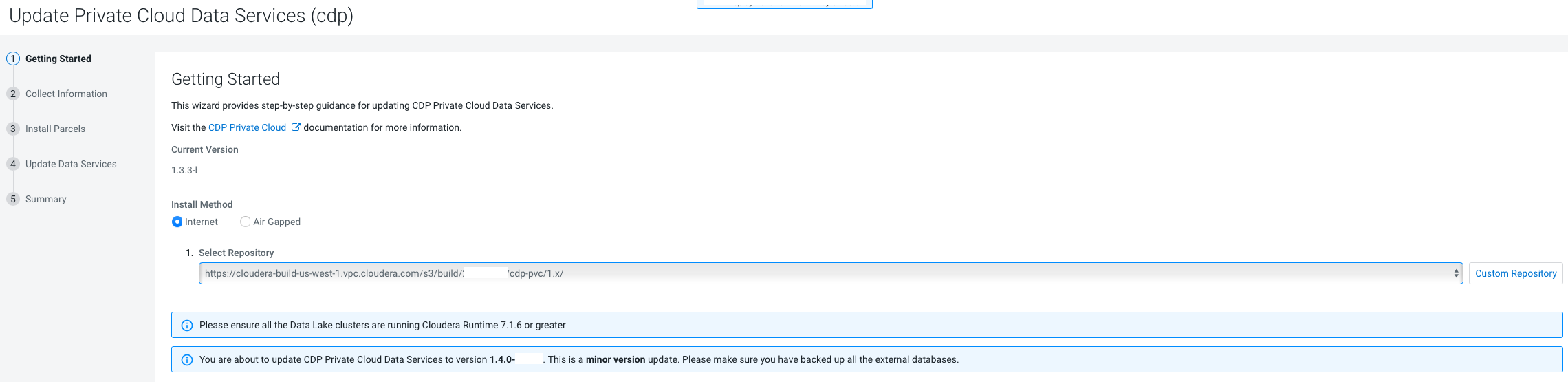

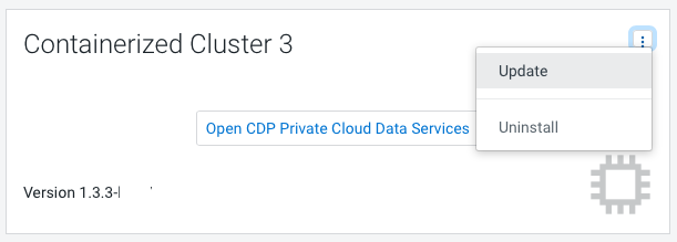

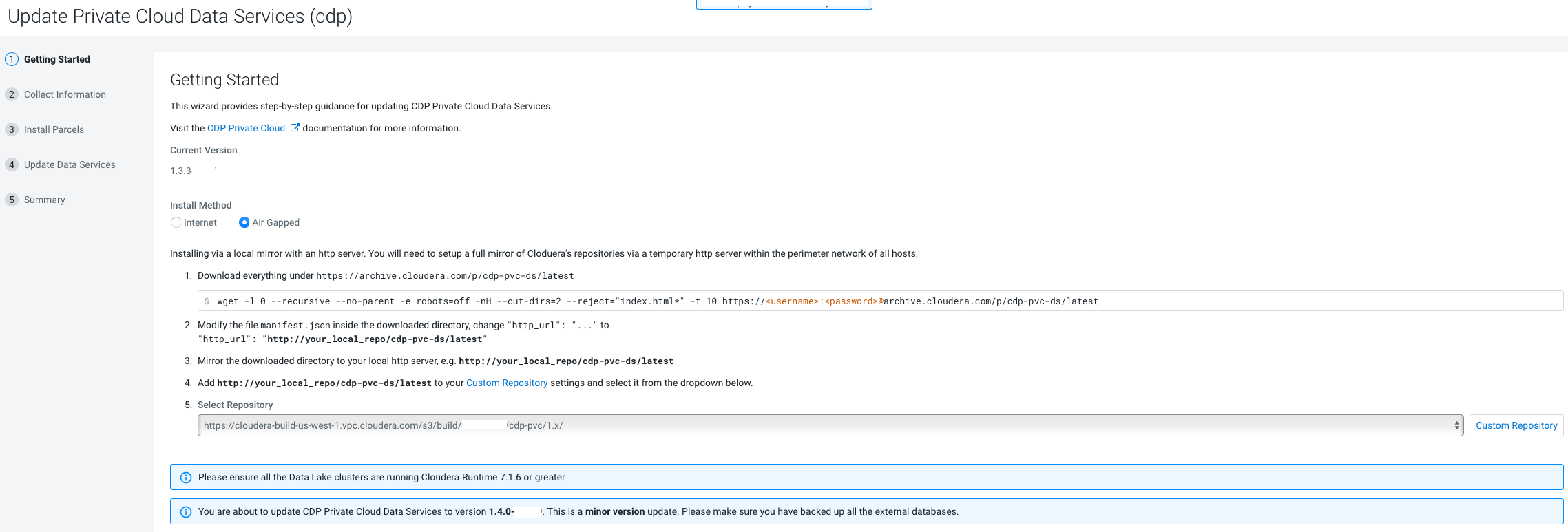

Update from 1.3.3 to 1.4.0/1.4.0-H1
You can update your existing CDP Private Cloud Data Services 1.3.3 to 1.4.0 or 1.4.0-H1 without requiring an uninstall.
