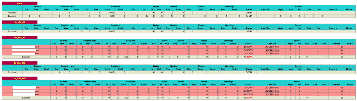

You can verify that all the hosts are shown from the HAproxy UI. However, at
this point the hosts are not listening to the configured ports.
