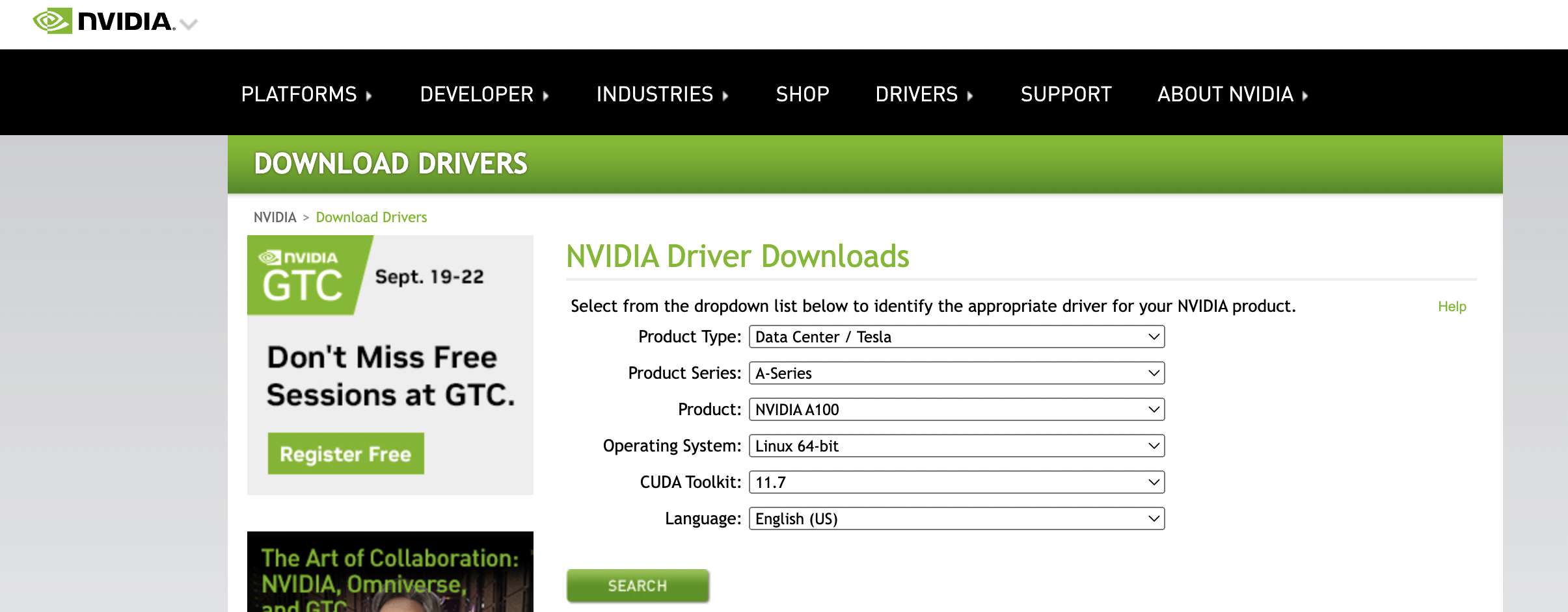

Use the NVIDIA Driver Downloads page to determine the software driver version required for your NVIDIA GPU card. This example uses a NVIDIA A100 GPU card, which requires driver version
515.65.01.

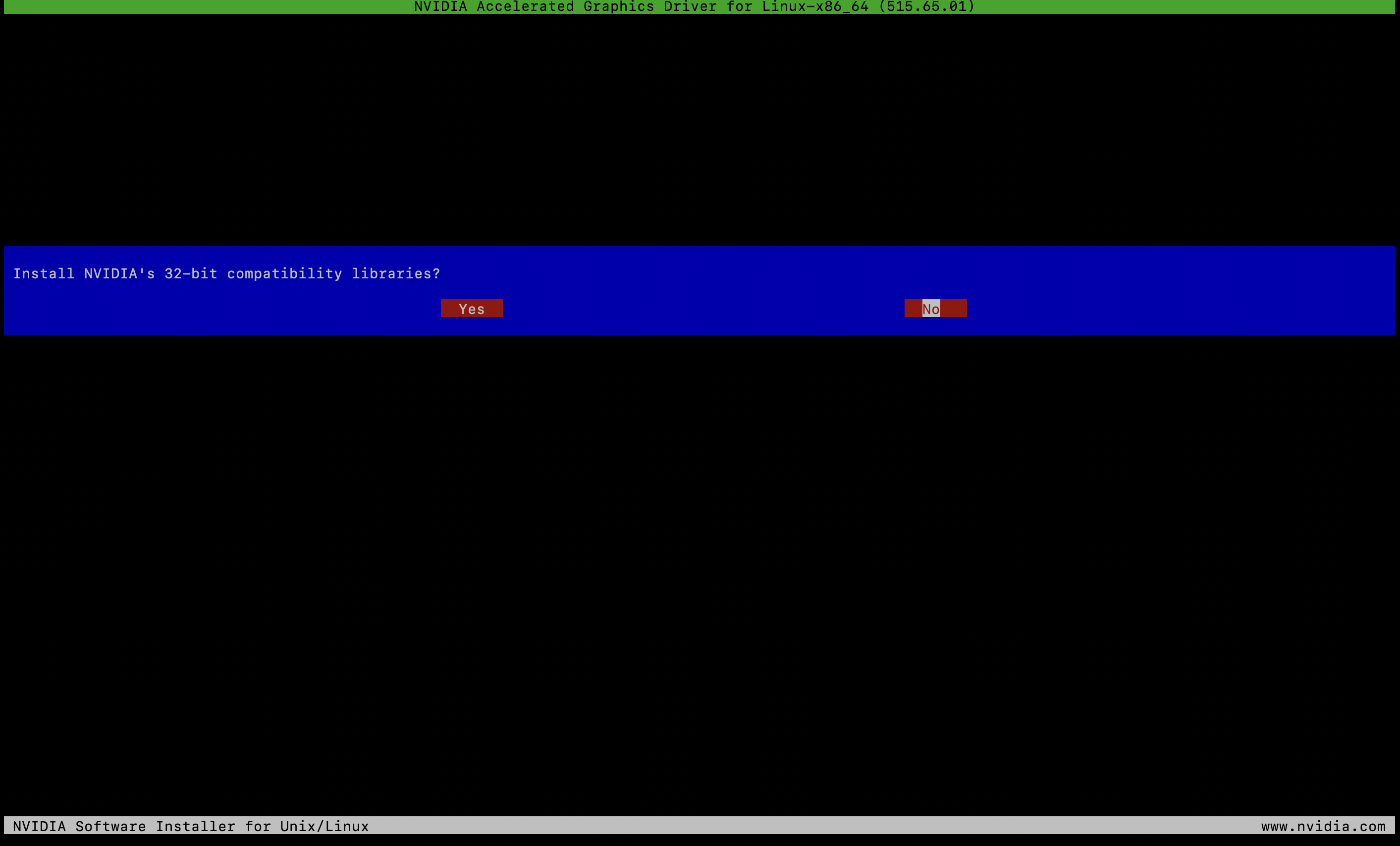

Next, run the following commands to install the NVIDIA driver and
nvidia-container-runtimesoftware:# BASE_URL=https://us.download.nvidia.com/tesla# DRIVER_VERSION=515.65.01 # curl -fSsl -O $BASE_URL/$DRIVER_VERSION/NVIDIA-Linux-x86_64-$DRIVER_VERSION.run # sh NVIDIA-Linux-x86_64-$DRIVER_VERSION.run
After the installation is complete, run the
nvidia-smitool and ensure that the driver was successfully deployed. The output should look similar to the following example:[root@ecsgpu ~]# nvidia-smi Wed Aug 24 13:03:46 2022 +-----------------------------------------------------------------------------+ | NVIDIA-SMI 515.65.01 Driver Version: 515.65.01 CUDA Version: 11.7 | |-------------------------------+----------------------+----------------------+ | GPU Name Persistence-M| Bus-Id Disp.A | Volatile Uncorr. ECC | | Fan Temp Perf Pwr:Usage/Cap| Memory-Usage | GPU-Util Compute M. | | | | MIG M. | |===============================+======================+======================| | 0 NVIDIA A100-PCI... Off | 00000000:08:00.0 Off | 0 | | N/A 32C P0 37W / 250W | 0MiB / 40960MiB | 3% Default | | | | Disabled | +-------------------------------+----------------------+----------------------+ +-----------------------------------------------------------------------------+ | Processes: | | GPU GI CI PID Type Process name GPU Memory | | ID ID Usage | |=============================================================================| | No running processes found | +-----------------------------------------------------------------------------+ [root@ecsgpu ~]# lsmod | grep nvidia nvidia_drm 53212 0 nvidia_modeset 1142094 1 nvidia_drm nvidia 40761292 1 nvidia_modeset drm_kms_helper 186531 3 qxl,nouveau,nvidia_drm drm 468454 7 qxl,ttm,drm_kms_helper,nvidia,nouveau,nvidia_drm [root@ecsgpu ~]# dmesg | grep nvidia [ 123.588172] nvidia: loading out-of-tree module taints kernel. [ 123.588182] nvidia: module license 'NVIDIA' taints kernel. [ 123.704411] nvidia: module verification failed: signature and/or required key missing - tainting kernel [ 123.802826] nvidia-nvlink: Nvlink Core is being initialized, major device number 239 [ 123.925577] nvidia-uvm: Loaded the UVM driver, major device number 237. [ 123.934813] nvidia-modeset: Loading NVIDIA Kernel Mode Setting Driver for UNIX platforms 515.65.01 Wed Jul 20 13:43:59 UTC 2022 [ 123.940999] [drm] [nvidia-drm] [GPU ID 0x00000800] Loading driver [ 123.941018] [drm] Initialized nvidia-drm 0.0.0 20160202 for 0000:08:00.0 on minor 1 [ 123.958317] [drm] [nvidia-drm] [GPU ID 0x00000800] Unloading driver [ 123.968642] nvidia-modeset: Unloading [ 123.978362] nvidia-uvm: Unloaded the UVM driver. [ 123.993831] nvidia-nvlink: Unregistered Nvlink Core, major device number 239 [ 137.450679] nvidia-nvlink: Nvlink Core is being initialized, major device number 240 [ 137.503657] nvidia-modeset: Loading NVIDIA Kernel Mode Setting Driver for UNIX platforms 515.65.01 Wed Jul 20 13:43:59 UTC 2022 [ 137.508187] [drm] [nvidia-drm] [GPU ID 0x00000800] Loading driver [ 137.508190] [drm] Initialized nvidia-drm 0.0.0 20160202 for 0000:08:00.0 on minor 1 [ 149.717193] nvidia 0000:08:00.0: irq 48 for MSI/MSI-X [ 149.717222] nvidia 0000:08:00.0: irq 49 for MSI/MSI-X [ 149.717248] nvidia 0000:08:00.0: irq 50 for MSI/MSI-X [ 149.717275] nvidia 0000:08:00.0: irq 51 for MSI/MSI-X [ 149.717301] nvidia 0000:08:00.0: irq 52 for MSI/MSI-X [ 149.717330] nvidia 0000:08:00.0: irq 53 for MSI/MSI-X -

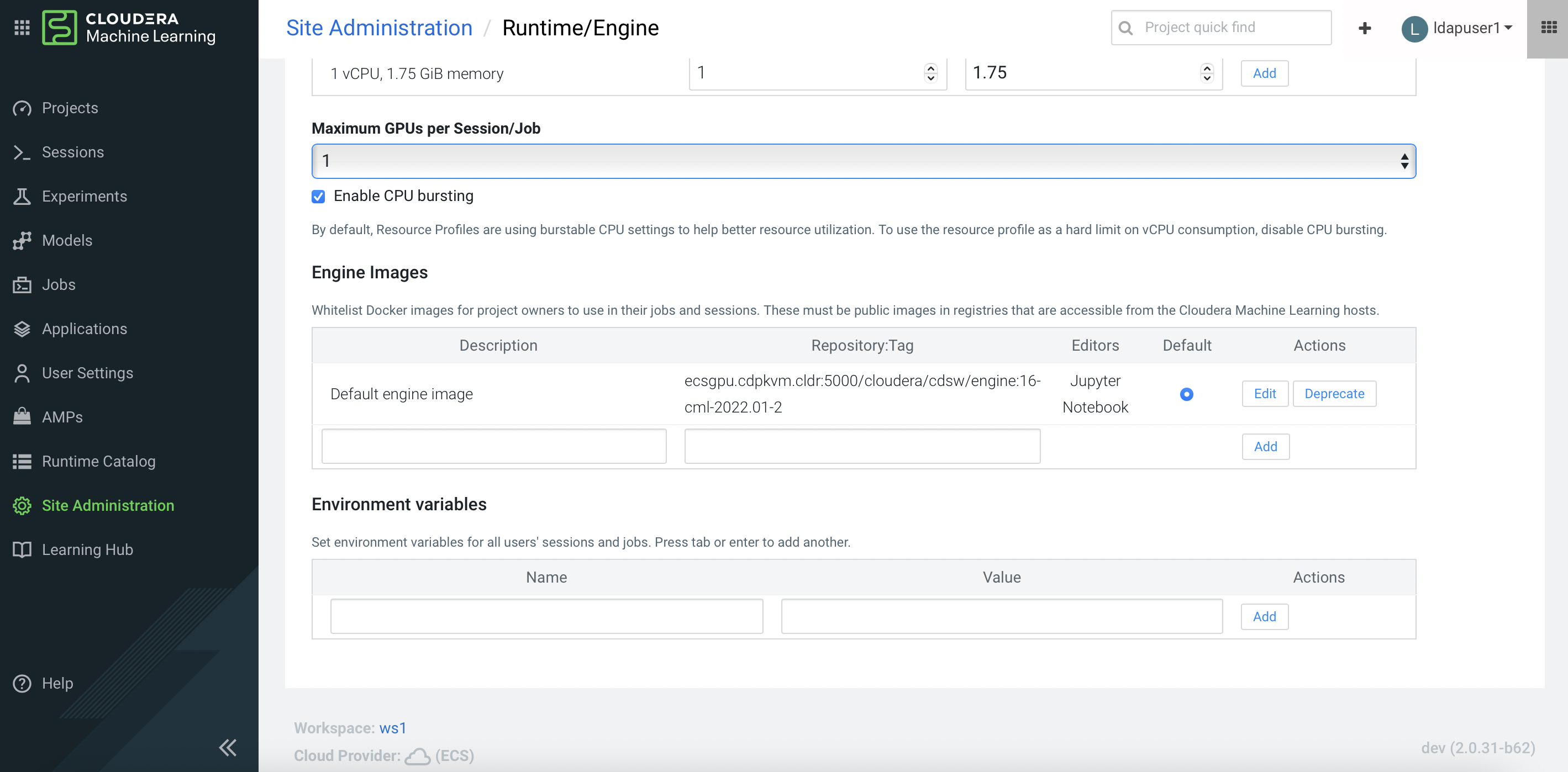

In the CDP Private Cloud Data Services CML workspace, select Site Administration > Runtime/Engine. Specify a number for Maximum GPUs per Session/Job. This procedure effectively allows the CML session to consume the GPU card.

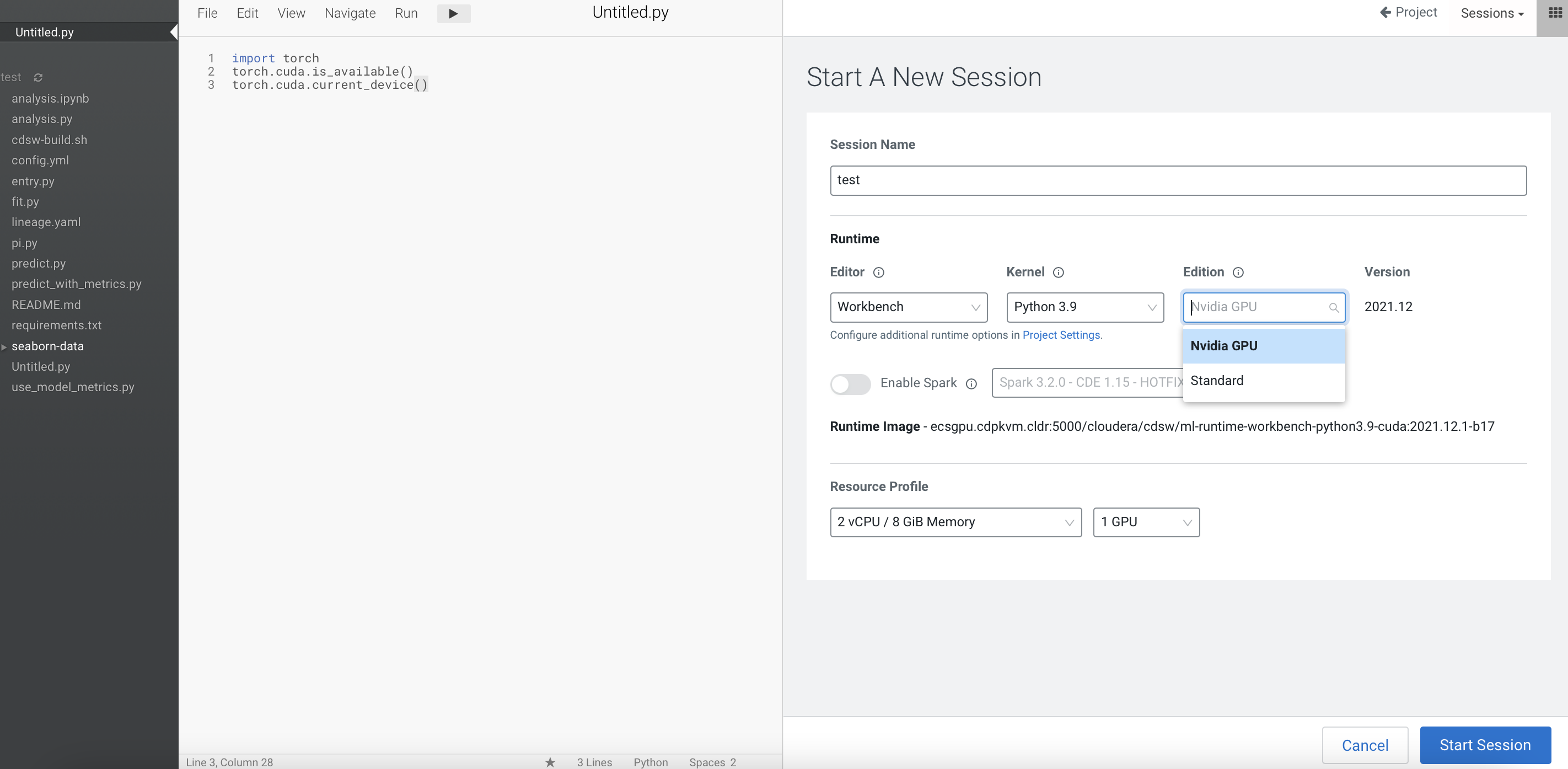

Create a CML project and start a new session by selecting the Workbench editor with a Python kernel and a NVIDIA GPU edition. Specify the number of GPUs to use – in this example, 1 GPU is specified.

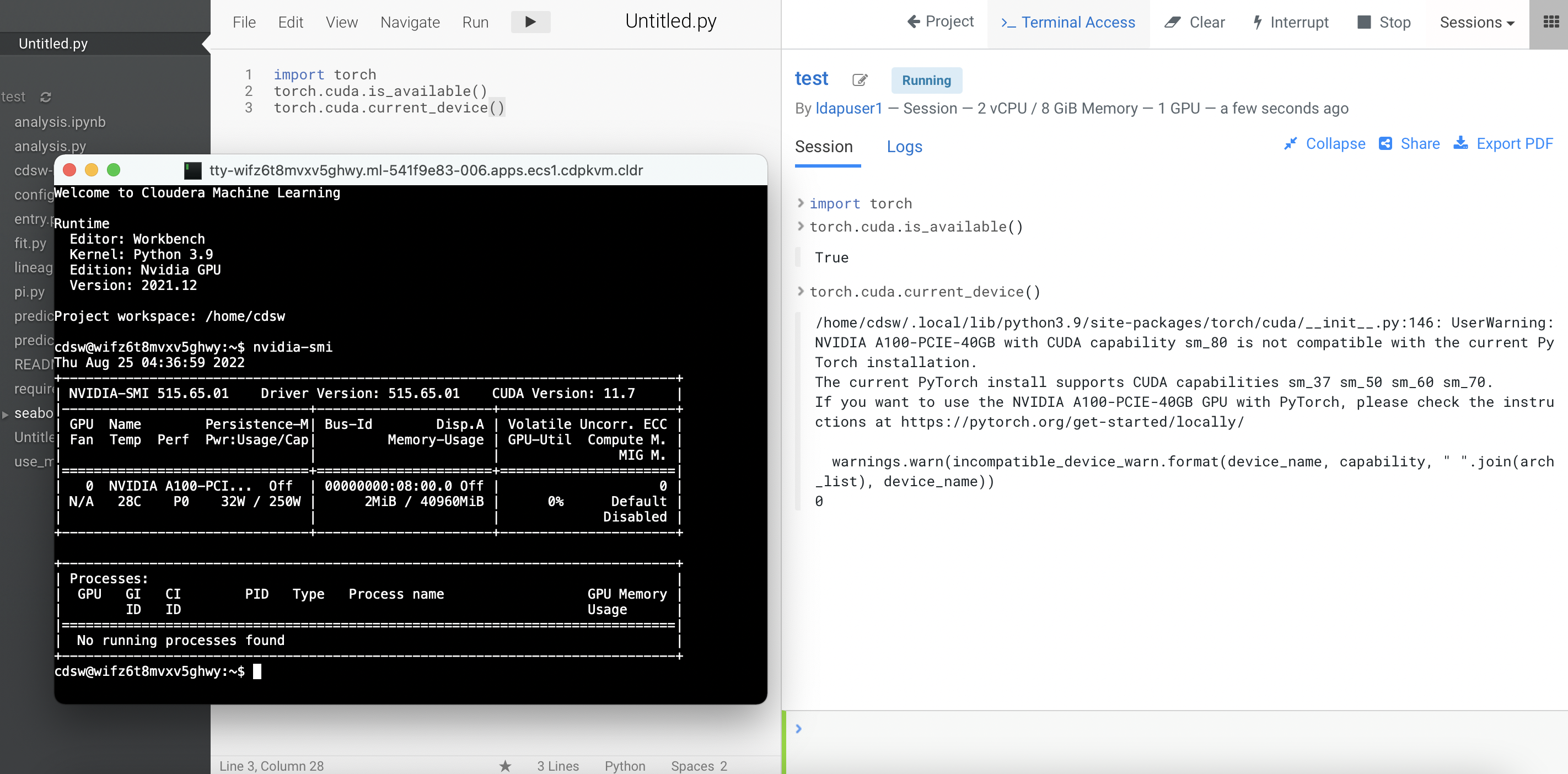

Create a new Python file and run the following script. Also, open the terminal session and run the
nvidia-smitool. Note that the output shows the NVIDIA GPU card details.!pip3install torchimport torchtorch.cuda.is_available()torch.cuda.device_count()torch.cuda.get_device_name(0)

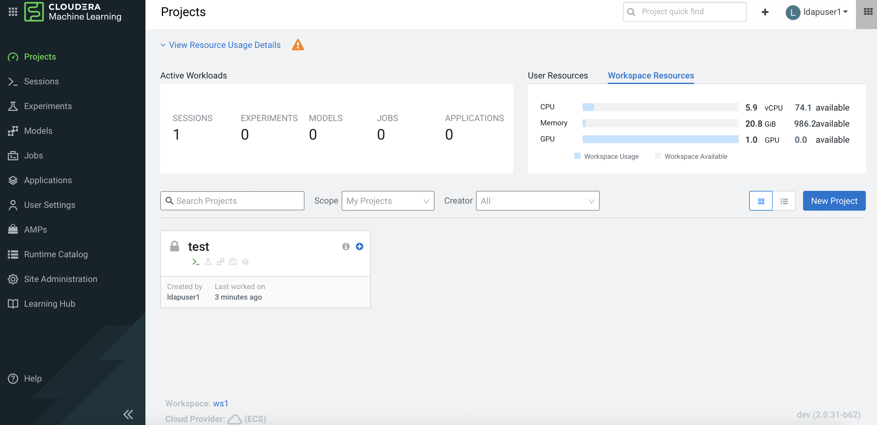

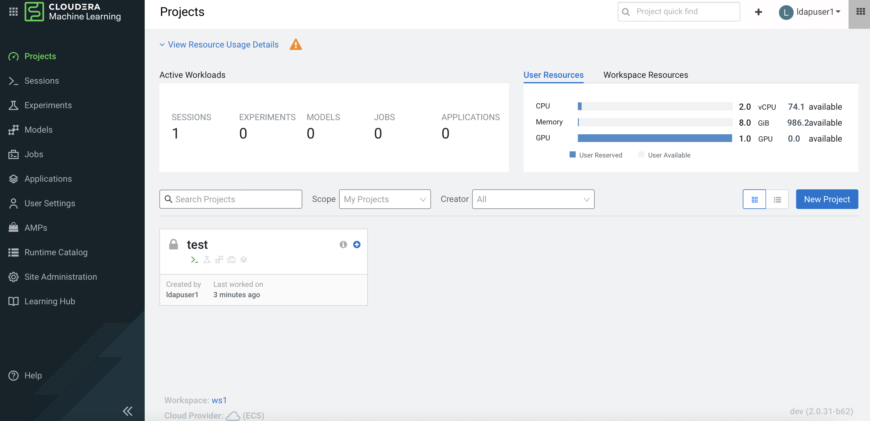

Navigate to the CML Projects page and confirm that the User Resources dashboard displays the GPU card availability.

When a process is consuming the NVIDIA GPU, the output of the
nvidia-smitool shows the PID of that process (in this case, the CML session pod).[root@ecsgpu ~]# nvidia-smi Thu Aug 25 13:58:40 2022 +-----------------------------------------------------------------------------+ | NVIDIA-SMI 515.65.01 Driver Version: 515.65.01 CUDA Version: 11.7 | |-------------------------------+----------------------+----------------------+ | GPU Name Persistence-M| Bus-Id Disp.A | Volatile Uncorr. ECC | | Fan Temp Perf Pwr:Usage/Cap| Memory-Usage | GPU-Util Compute M. | | | | MIG M. | |===============================+======================+======================| | 0 NVIDIA A100-PCI... Off | 00000000:08:00.0 Off | 0 | | N/A 29C P0 35W / 250W | 39185MiB / 40960MiB | 0% Default | | | | Disabled | +-------------------------------+----------------------+----------------------+ +-----------------------------------------------------------------------------+ | Processes: | | GPU GI CI PID Type Process name GPU Memory | | ID ID Usage | |=============================================================================| | 0 N/A N/A 29990 C /usr/local/bin/python3.9 39183MiB | +-----------------------------------------------------------------------------+ -

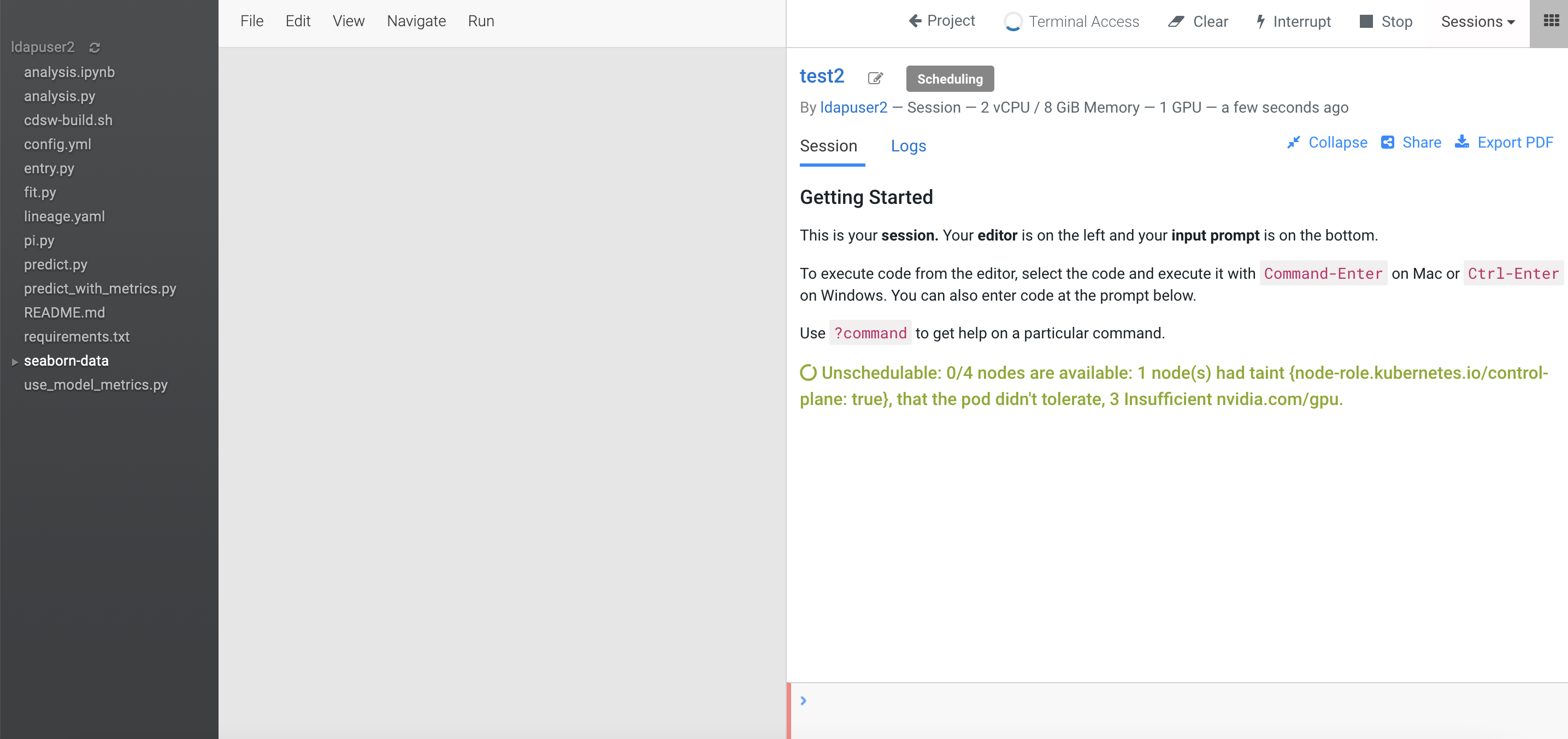

In the event that the ECS platform has no available worker node with a GPU card, provisioning a session with GPU will result in a
Pendingstate as the system is looking for a worker node installed with at least one NVIDIA GPU card.
