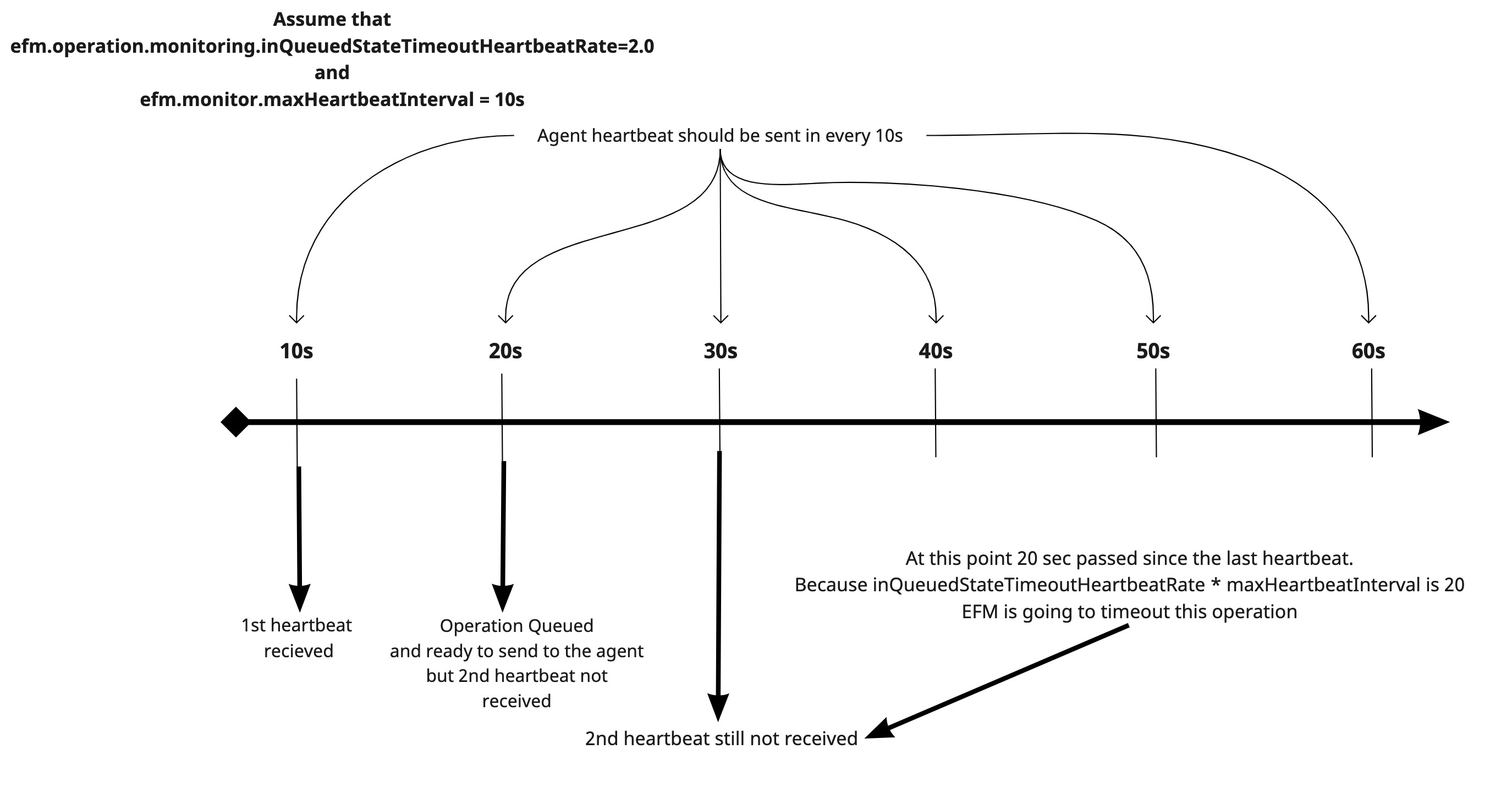

In case when not all agents are healthy you are faced with the issue that your bulk operation slows down drastically because of the lack of responses from agents. So the operation is stuck at EFM side and unable to send anything to the agent. In order to control this situation, you can define
efm.monitor.maxHeartbeatInterval=10sandefm.operation.monitoring.inQueuedStateTimeoutHeartbeatRate=2.0.The following chart shows you how this situation looks like on a timeline:

You can set
maxHeartbeatInterval=12because if the agent is online you must receive a heartbeat in 10s but you allow some buffer. The 1 min outage could cause you to miss 6-7 heartbeats. So you setinQueuedStateTimeoutHeartbeatRate=8.It means EFM waits for 96 seconds before timing out that operation.
