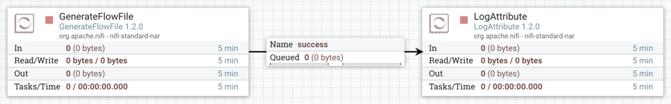

The dataflow should look like the following:
