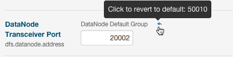

To reset a property back to its default value, click
the
icon. The default value is inserted and the
icon turns into an Undo icon (
). Explicitly setting a configuration to the
same value as its default (inherited value) has the same effect as using
the
icon.
