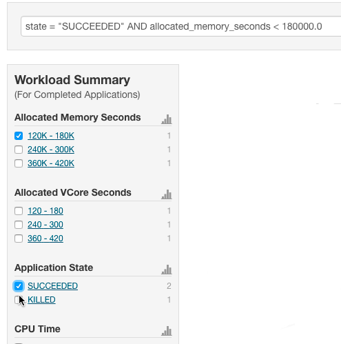

text box. - Construct a Filter from the Workload Summary
Attributes: Optionally, click Select
Attributes to display a dialog box where you can chose attributes to
display in the Workload
Summary section. Select the checkbox next to one or more attributes and
click Close. Only attributes
that support filtering appear in the Workload Summary section. See the Attributes table.The attributes display in the Workload Summary section along with values or ranges of values that you can filter on. The values and ranges display as links with checkboxes. Select one or more checkboxes to add the range or value to the query. Click a link to run a query on that value or range. For example:
