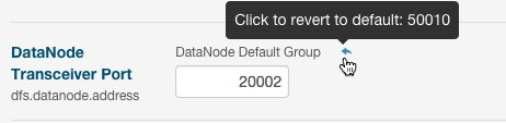

Resetting Configuration Properties to the Default Value
To reset a property back to its default value, click
the
icon. The default value is inserted and the
icon turns into an Undo icon (
). Explicitly setting a configuration to the
same value as its default (inherited value) has the same effect as using
the
icon.
the
icon.
There is no mechanism for resetting to an autoconfigured value. However, you can use the configuration history and rollback feature to revert any configuration changes.
