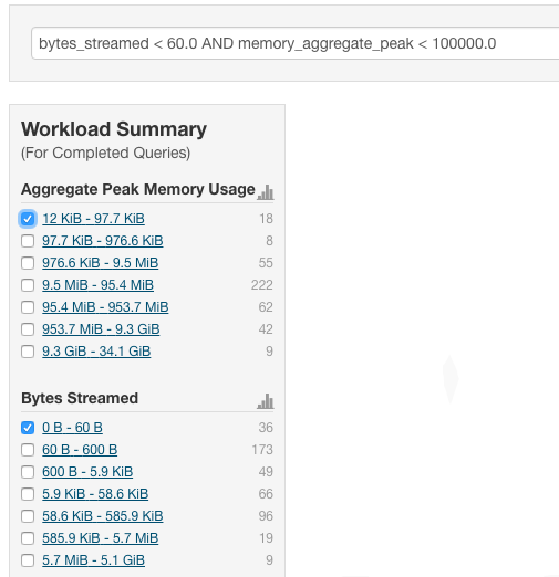

text box. - Construct a Filter from the Workload Summary Attributes: Optionally, click
Select Attributes to display
a dialog box where you can chose which attributes to display in the Workload Summary section. Select the
checkbox next to one or more attributes, and click Close.The attributes display in the Workload Summary section along with values or ranges of values that you can filter on. The values and ranges display as links with checkboxes. Select one or more checkboxes to add the range or value to the query. Click a link to run a query on that value or range. For example:
