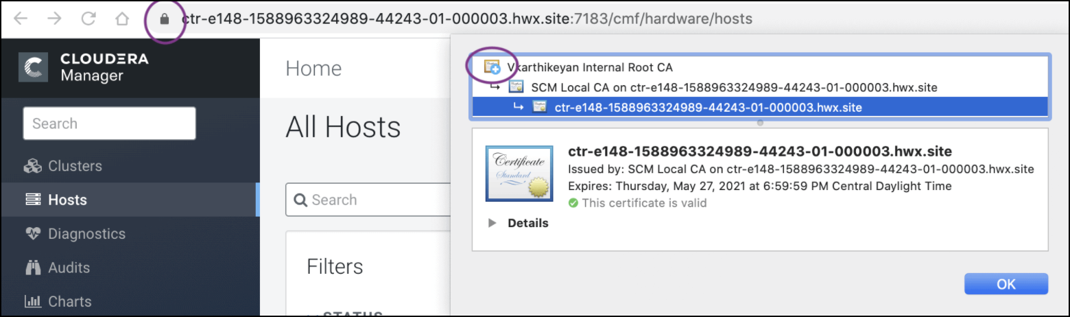

.JAVA_HOME=/usr/lib/jvm/java-1.8.0-openjdk; /opt/cloudera/cm-agent/bin/certmanager --location /var/lib/cloudera-scm-server/certmanager setup --configure-services --trusted-ca-certs ca-certs.pem --signed-ca-cert=cm_cert_chain.pem. X509v3 Basic Constraints: critical CA:TRUE, pathlen:0 X509v3 Key Usage: critical Digital Signature, Certificate Sign, CRL Sign - Start Cloudera Manager on TLS port 7183. If the signed intermediate certificate is
already imported into the client browser’s truststore, then you should not see any
warnings. In the screenshot below, “Vkarthikeyan Internal Root CA” is the root
certificate. This certificate is already trusted by the system and has signed the Cloudera
intermediate CA.
