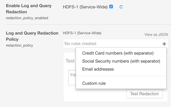

Enabling Log and Query Redaction Using Cloudera Manager
- Login to the Cloudera Manager Admin Console.
- Select .
- Click the Configuration tab.
- In the Search box,
type
redactionto find the redaction property settings:- Enable Log and Query Redaction
- Log and Query Redaction Policy List of rules for redacting sensitive information
from log files and query strings. Choose a preconfigured rule or add a custom
rule. See
How Redaction Rules Work
for more information about rule pattern definitions.
Test your rules:- Enter sample text into the Test Redaction Rules text box
- Click Test Redaction.
- Click Save Changes.
- Restart the cluster.
If no rules match, the text you entered displays in the Results field, unchanged.
