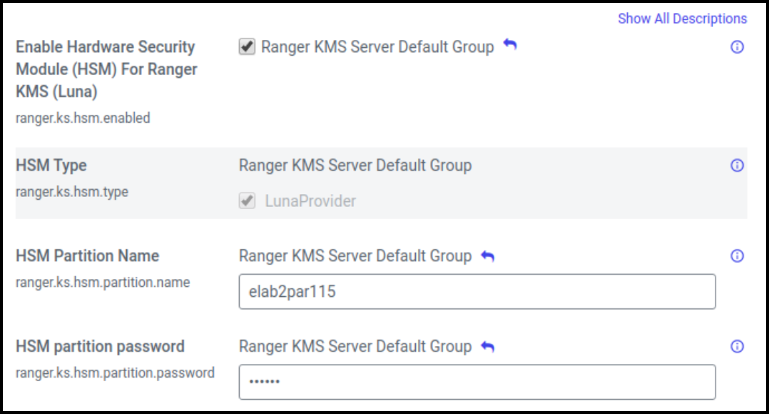

Set KMS Configuration Properties.
In Cloudera Manager > Ranger KMS > Configs edit the following properties:
ranger.ks.hsm.type = LunaProvider ranger.ks.hsm.enabled = true ranger.ks.hsm.partition.name=elab2par115 ranger.ks.hsm.partition.password=hanuman123 (CM-7.1.1 & CM-7.1.2 password will be in plain text)Figure 1. Adding Ranger KMS Configuration for Luna 7 HSM
- Restart Ranger KMS from Cloudera Manager.
