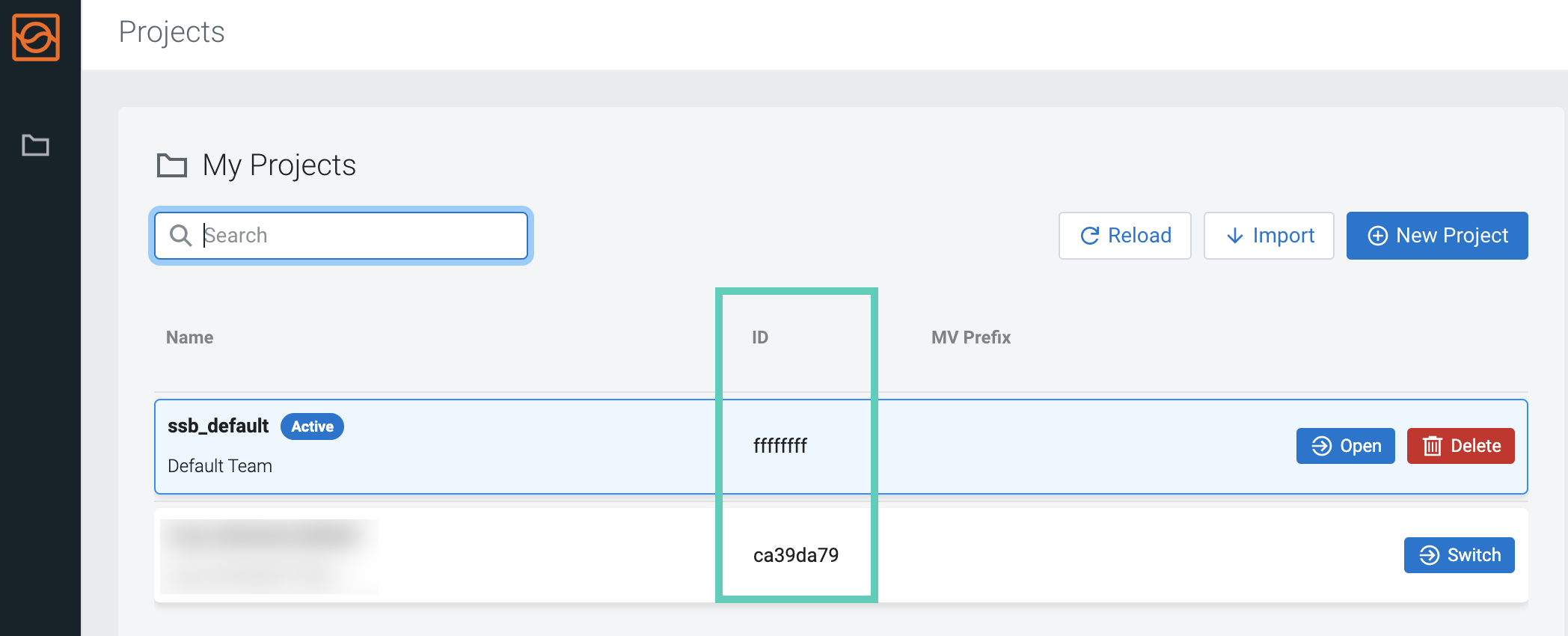

Accessing the project ID
GET /api/v2/projects call in CLI to list all
projects that the user has access to.Using REST API Tool

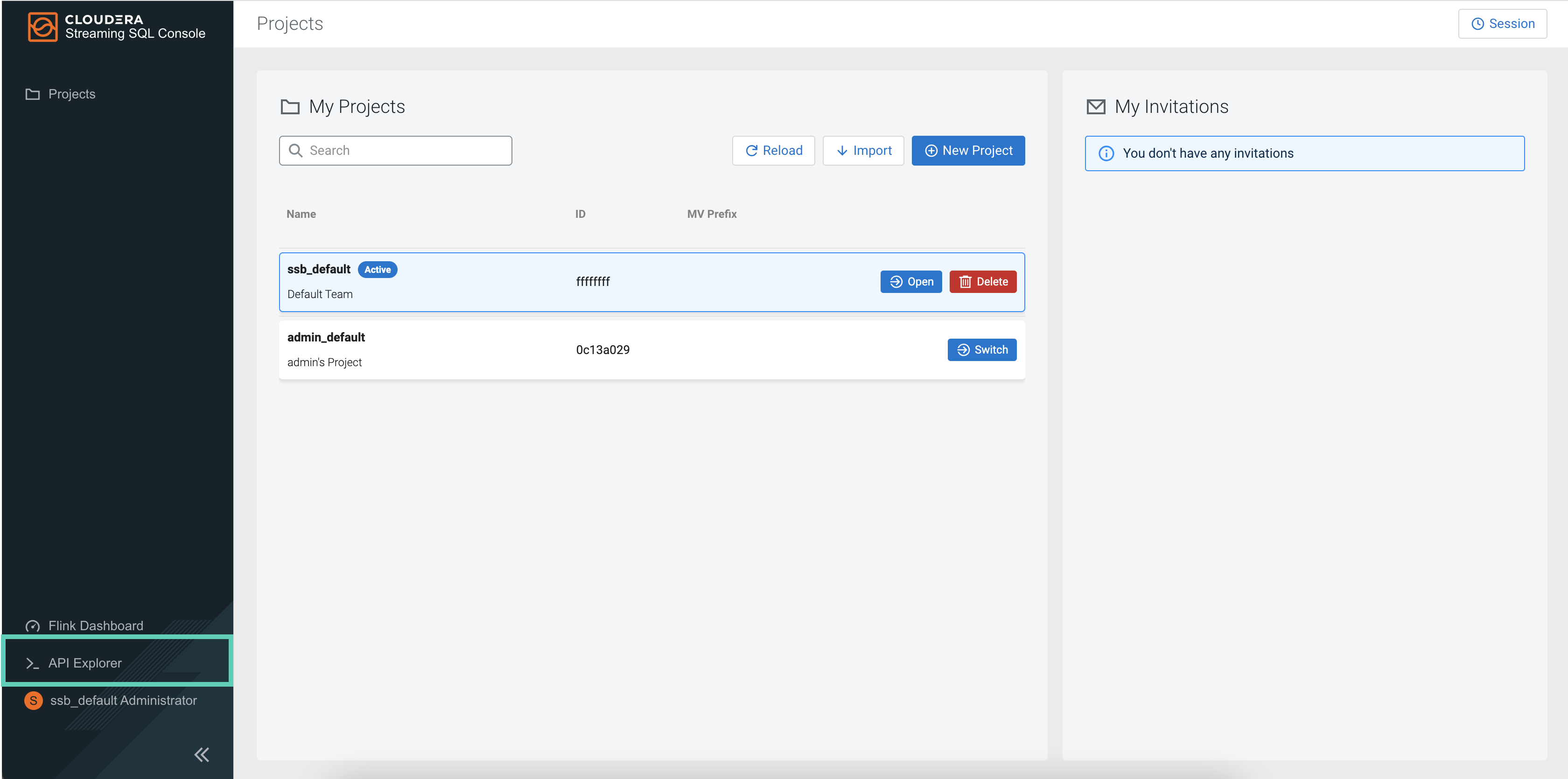

Using Swagger UI
You can access the Swagger UI to use the SSB REST API by adding your hostname and the Streaming SQL Engine port to the Swagger UI URL.
http(s)://[***CLUSTER_DOMAIN***]:[***STREAMING_SQL_ENGINE_SERVER_PORT***]/swagger-ui/index.html?configUrl=/swagger/api-docs/swagger-config
You can also download the swagger.json for the SSB REST API using the Swagger
UI.
