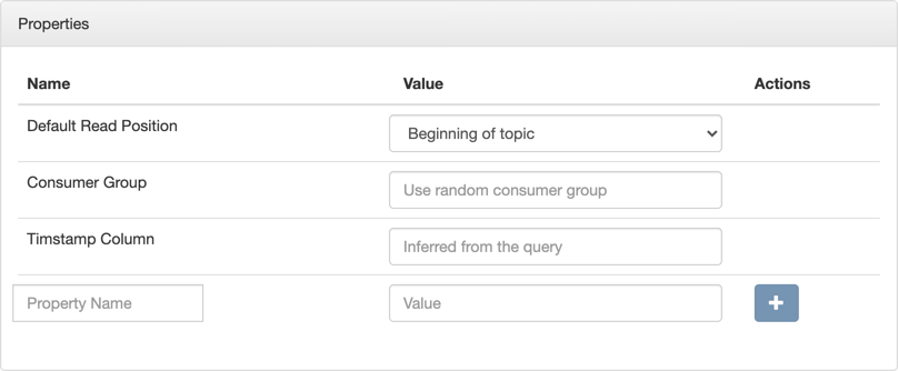

- Properties
- You can specify certain properties to define your source in detail. You can add customized
properties additionally to the default ones. To create properties, you need to give a name to
the property and provide a value for it, then click Actions.
