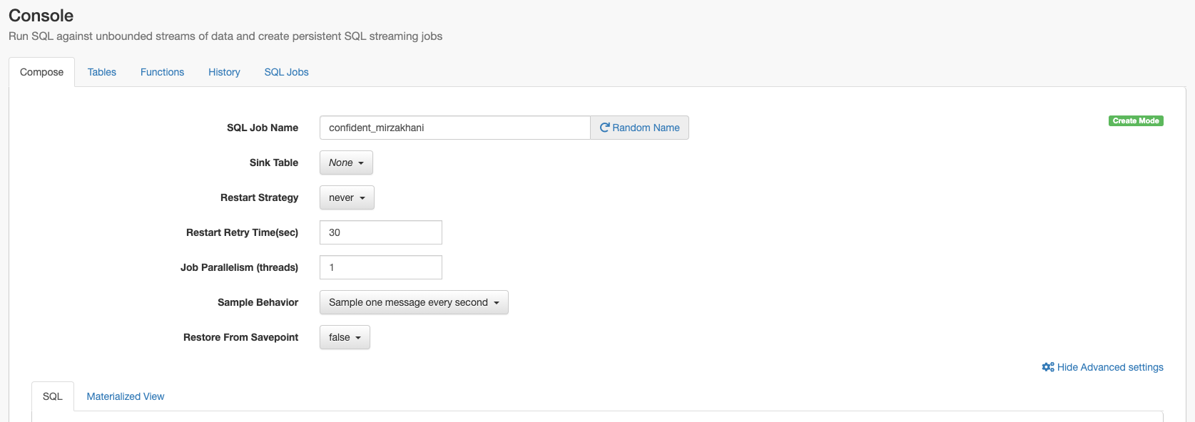

Restart strategy and restart retry time
The job is restarted after Restart Retry Time seconds, if set to Always. It is not restarted if you select Stop from the SQL Jobs tab. If set to Never, the job does not restart unless you select Restart from the Compose tab.
Job parallelism
The number of threads to start to process the job. Each thread consumes a slot on the cluster. When the Job Parallelism is set to 1, the job consumes the least resources. If the data provired supports parallel reads, increasing the parallelism can raise the maximum throughput. For example, when using Kafka as a data provider, setting the parallelism to the equal number as the partitions of the topic can be a starting point for performance tuning.
Sample behavior
How often to sample data (in milliseconds) from the output stream. 1000ms is common and recommended.
Restore From Savepoint
Enabling restoring from savepoint for the SQL job, using the state in Flink.
