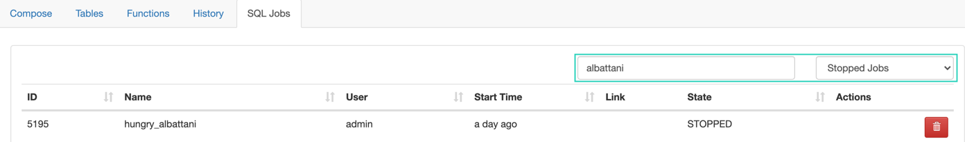

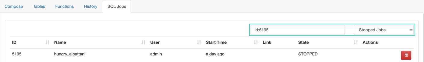

- You can further filter down the job list by searching for the job name, or locate
a specific job ID by prefixing your search with
id.

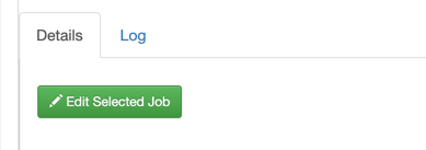

- Click Edit Selected Job under the Details tab.
The SQL job and its configuration is loaded in the SQL window on the Compose page.

- You can further filter down the results, by directly searching for the job name in the Search field.

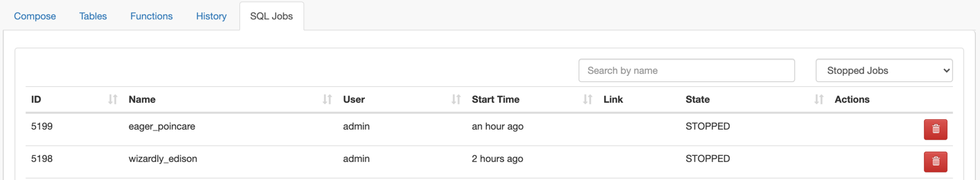

Deleting a SQL Stream job
You can delete a stopped SQL job from SQL Stream Builder on the SQL Jobs tab. By deleting the SQL job, you remove them from the list of stopped jobs.
- Click Console on the main menu.
- Select SQL Jobs tab.
By default, Running Jobs are displayed on the SQL Jobs page.
- Select Stopped Jobs from the drop-down menu.
The list of stopped jobs is diplayed on the SQL Jobs page.
- Click on Delete under Actions.
