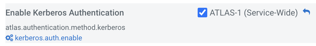

- Enable the Kerberos Authentication for the Atlas
service.

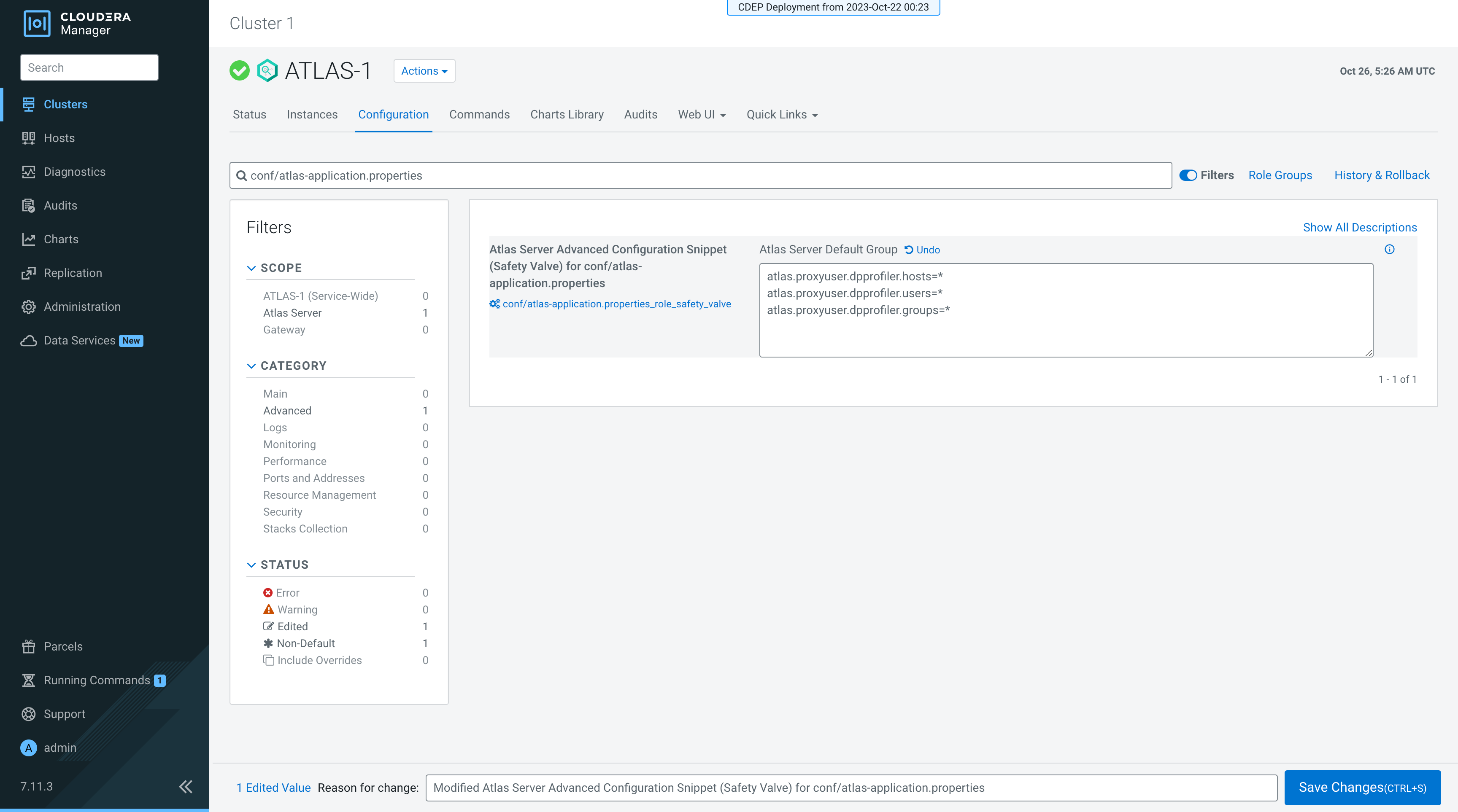

- In the search bar, look up the following
property:
conf/atlas-application.properties_role_safety_valveand enter the values for the Atlas service:atlas.proxyuser.dpprofiler.hosts=*atlas.proxyuser.dpprofiler.users=*atlas.proxyuser.dpprofiler.groups=*

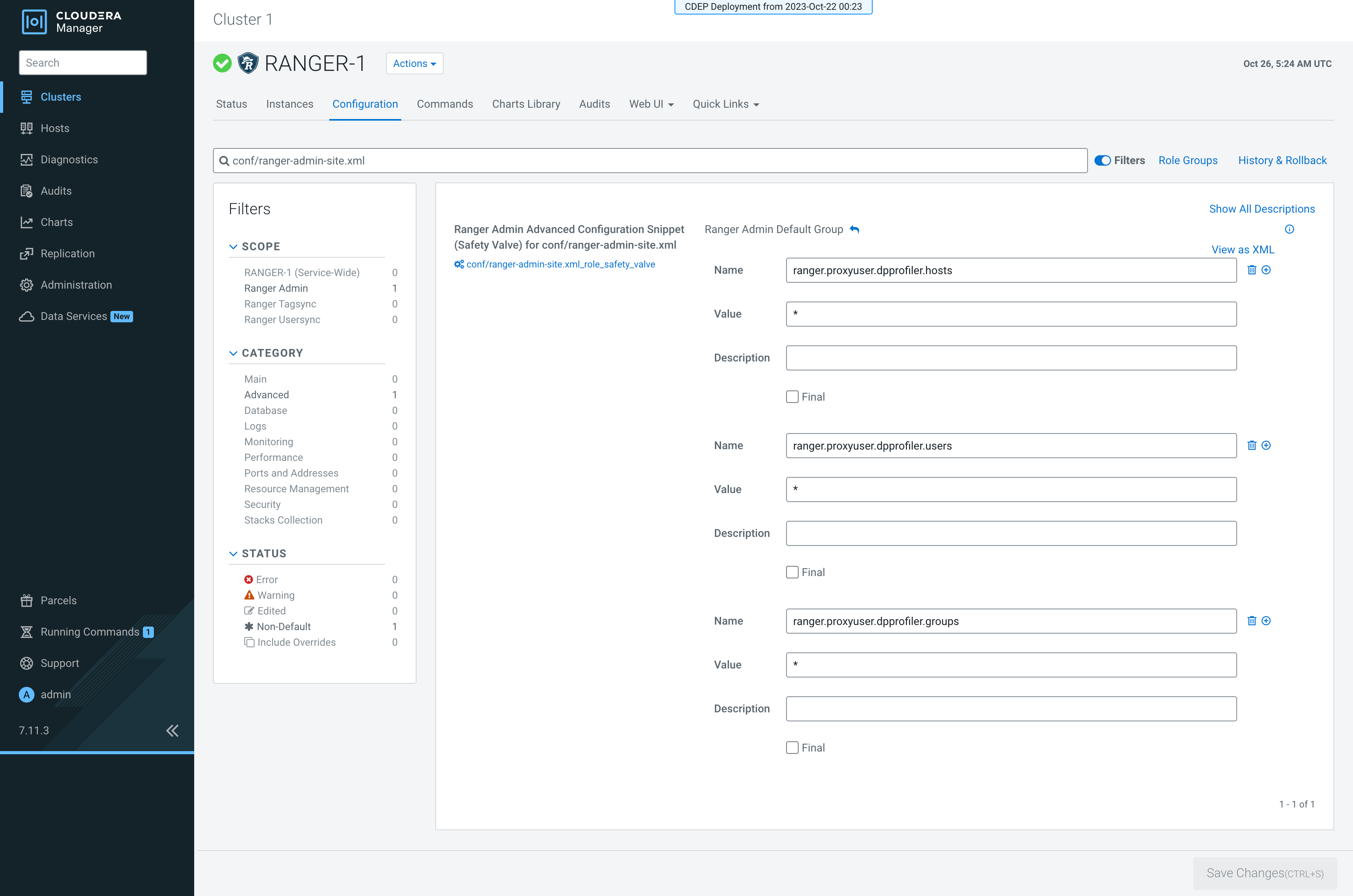

- For the Ranger configuration updates, go to > > > .
property:
conf/ranger-admin-site.xmland enter the values for the Ranger service:Name:
ranger.proxyuser.dpprofiler.hostsValue:
*Name:
ranger.proxyuser.dpprofiler.usersValue:
*Name:
ranger.proxyuser.dpprofiler.groupsValue:
