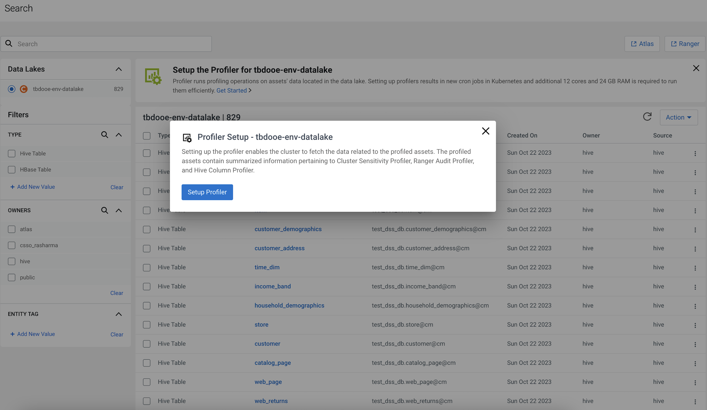

If your profiler is not launched for the selected data lake, follow these steps:

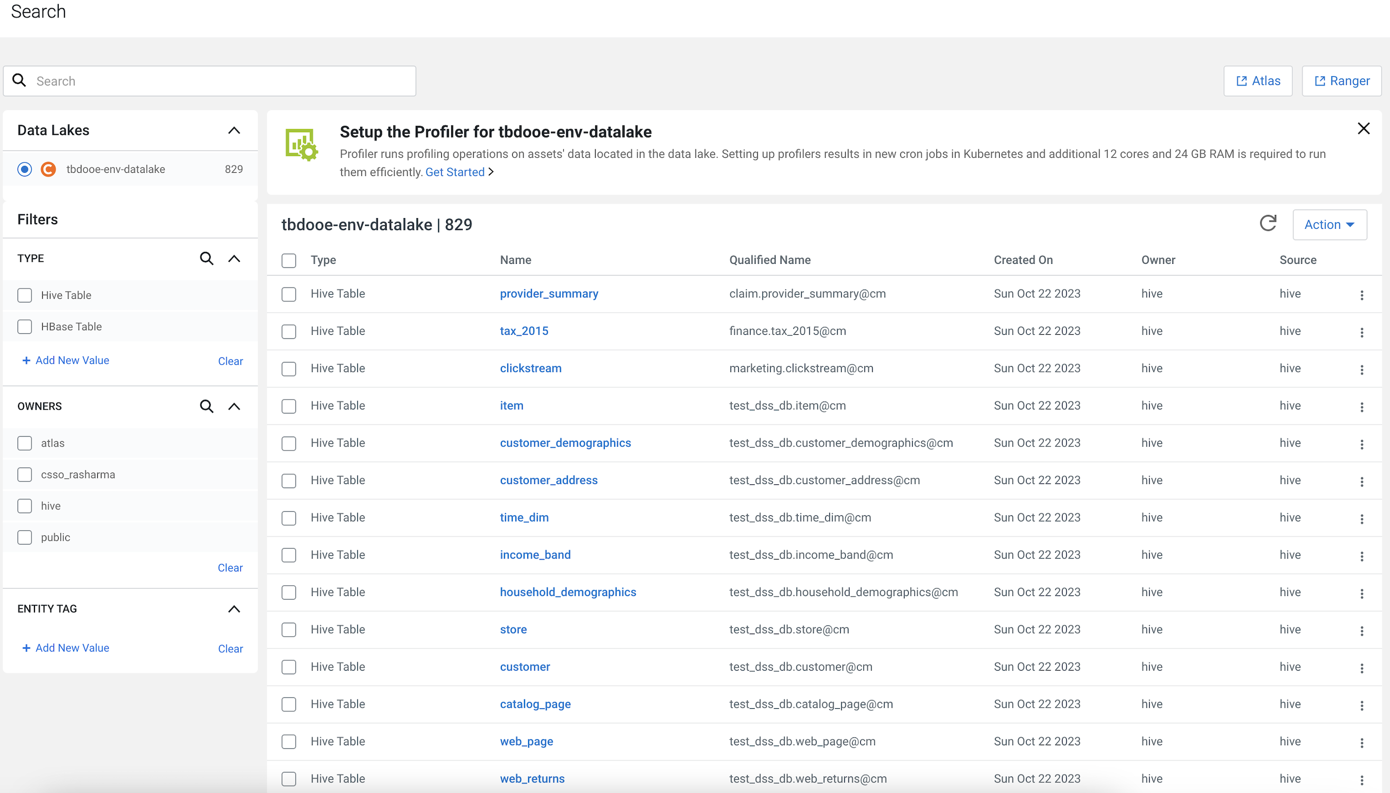

- From the Search menu > select the data lake for which you
want to profile the data.
The setup profiler page is displayed for the data lake.
- Click the Get Started link.
The Profiler setup for the data lake window appears.
Click Setup Profiler button to launch the profiler
