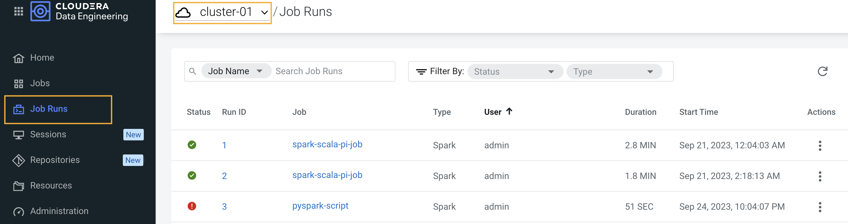

- In the Cloudera Data Platform (CDP) console, click the Data Engineering tile. The CDE Home page displays.

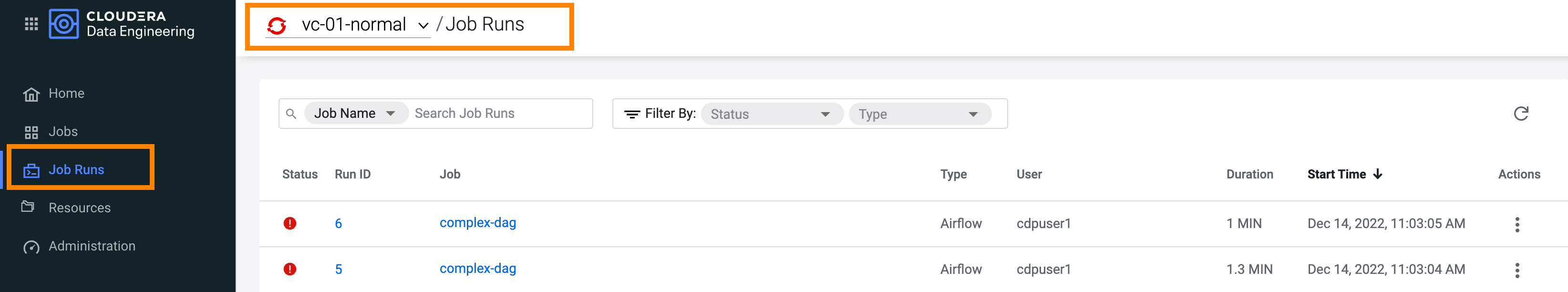

- Click Job Runs on the left navigation menu. The Job Runs page displays.
- Using the dropdown menu, select the virtual cluster containing the application you
want to
manage.
