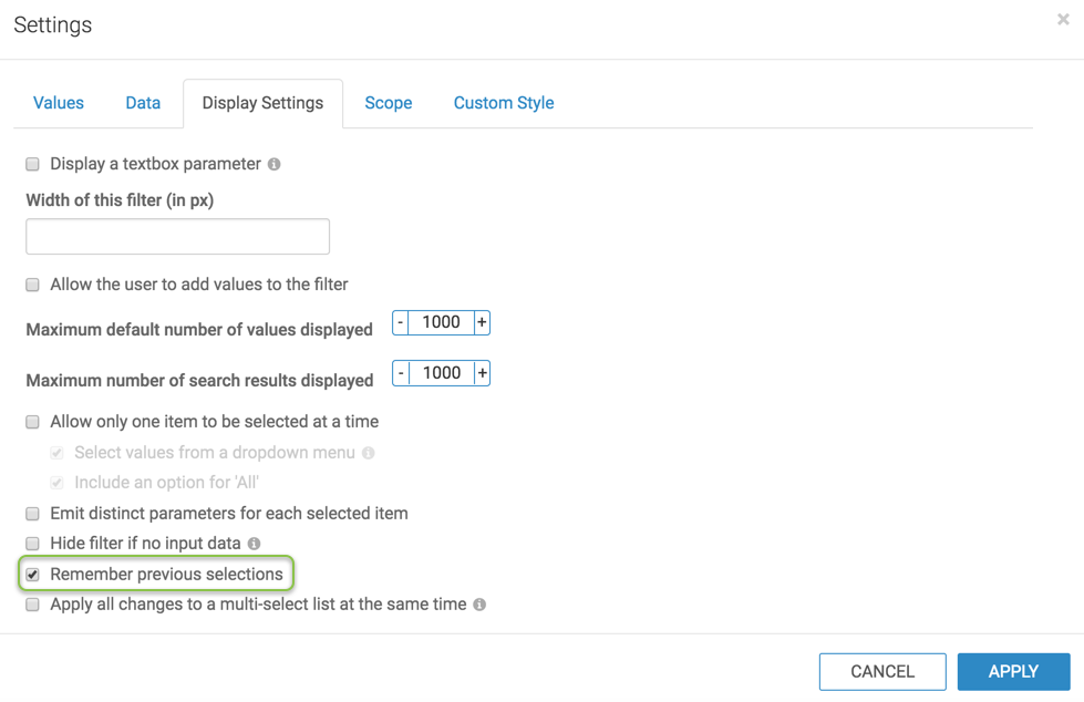

Enabling 'Remember Previous Selections'

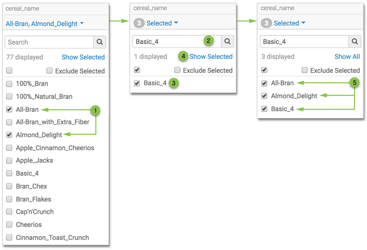

Using Filters with 'Remember Previous Selection'
To see how the 'Remember previous selections' option works, you must see the dashboard in View mode. Contrast this with the next section, Using Filters Without 'Remember Previous Selection'.
Here, we are using a dashboard based on Cereals dataset, and a dashboard filter based on the dataset field cereal_name.
Follow these steps:

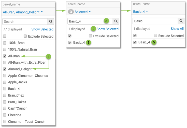

When this option is disabled, the user is unable to see the previous selections.
Here, we are using the same dashboard and filter on cereal_name as in the previous section, Using Filters with 'Remember Previous Selection', but with the option disabled.
To use the filter without the option, follow these steps:
