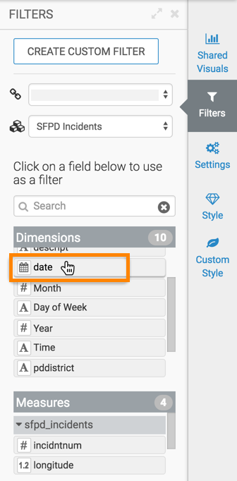

Switch to the Filters tab on the Dashboard
Designer side menu bar.
Under Dimensions, click the
date field.

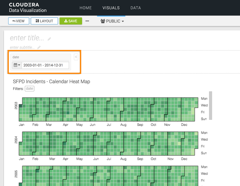

This adds a filter to the dashboard. This filter is based directly on the
date field and has a timestamp type.

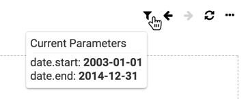

The dashboard filter contains the date range for the entire dataset; in this case, it
is from 2003-01-01 through 2014-12-31.

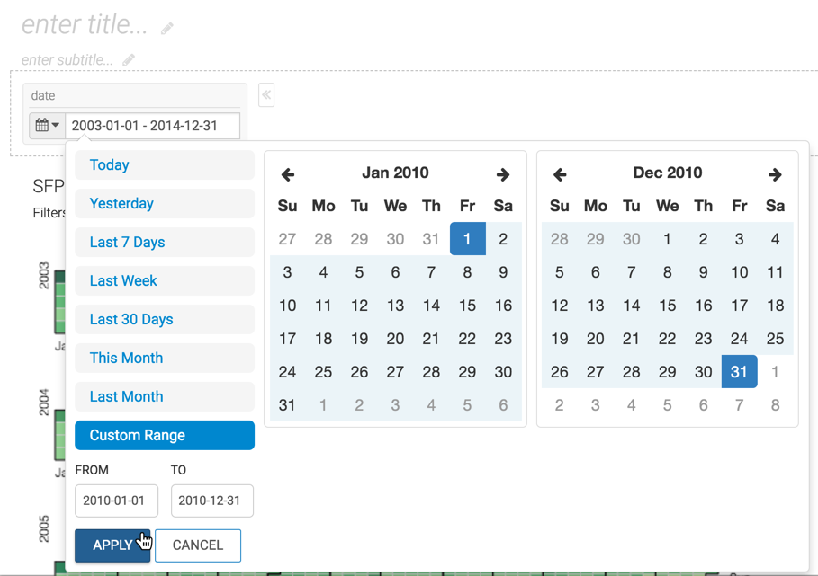

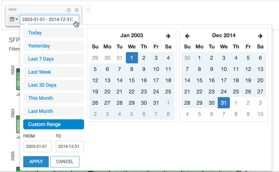

To use the date range picker interface, click the Calendar icon
on the filter, and select Fixed Dates from the menu.
You can also click the date field of the dashboard filter to see the date range picker
interface.
You can change the date range in various ways:
- By selecting the default options:
- Today
- Yesterday
- Last 7 Days
- Last Week
- Last 30 Days
- This Month
- Last Month
- By changing the date entries for FROM and
TO fields
- By picking the start and end dates directly on the calendar interface

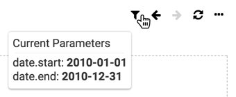

Change the date range to 2010-01-01 through 2010-12-31, and click
APPLY.
The visual output is now limited to the 2010 calendar year and the application
filter shows this new date range.
