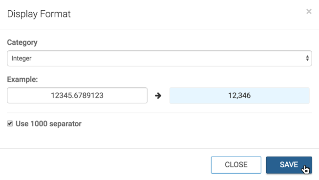

Integer display format
Data Visualization enables you to specify integer format for a numerical field.
The following steps demonstrate how to adjust the display format for an integer inside a visual, by setting a comma thousands separator.
- Click the field you plan to modify, to open the Field Properties menu.
- Under Field Properties, click Display Format.
- In the Display Format interface, select Integer from the Category menu.
- Make adjustments as needed: Select or de-select the Use 1000 separator option.
- Click Save.
- Click Refresh Visual.
