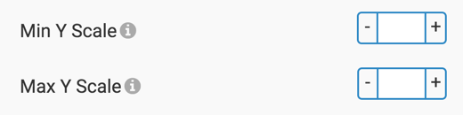

To change the minimum and maximum scale of a continuous Y axis of a scatter visual, navigate to the Axes menu, and make adjustments to the two selectors, Min Y Scale and Max Y Scale.

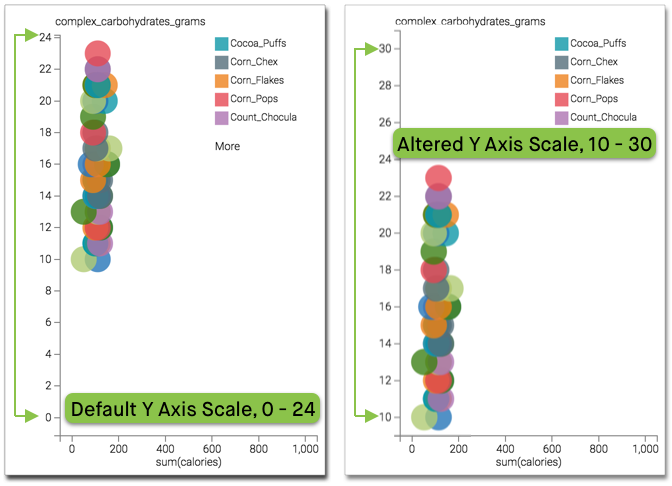

The image on the left shows the minimum and maximum scale of the Y axis from
0 to 24. Notice in the right image, how the scale changes
when we changed the values from 10 to 30. Increasing the
scale gives a clearer visual representation of where the carbohydrate levels fall within a
range of values.
