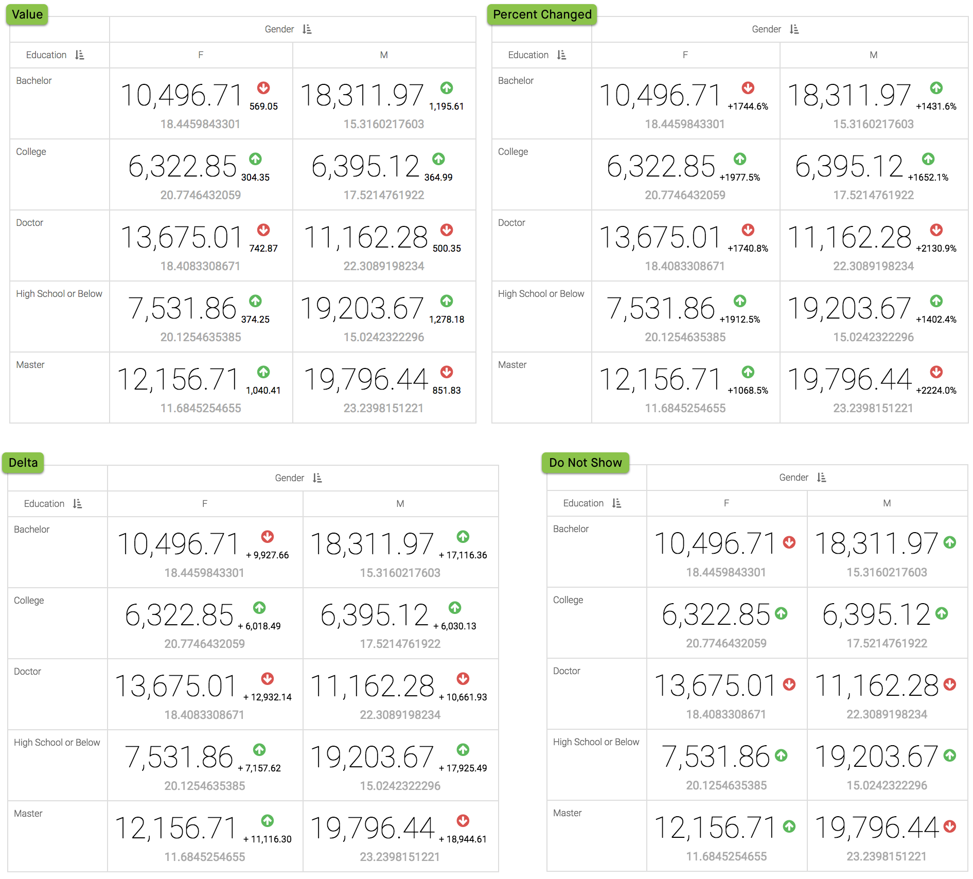

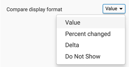

To specify what is reported by the compare indicator, navigate to the Marks menu, and select in Compare Display one of the options:
- Value (default), that appears on the Compare To shelf
- Percent Changed, difference between the main indicator value and Compare To value, as percentage
- Delta, the arithmetic difference between the main indicator value and Compare To value
- Do not Show, to remove this indicator from the visual
This image illustrates the visual with compare indicator displayed as a Value, Percent Changed, Delta, and Do Not Show.
