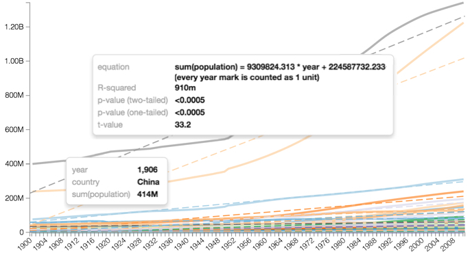

Here is a line visual with trendlines. In the following example, notice that a linear trendline clearly shows that population of China has consistently risen over the years.

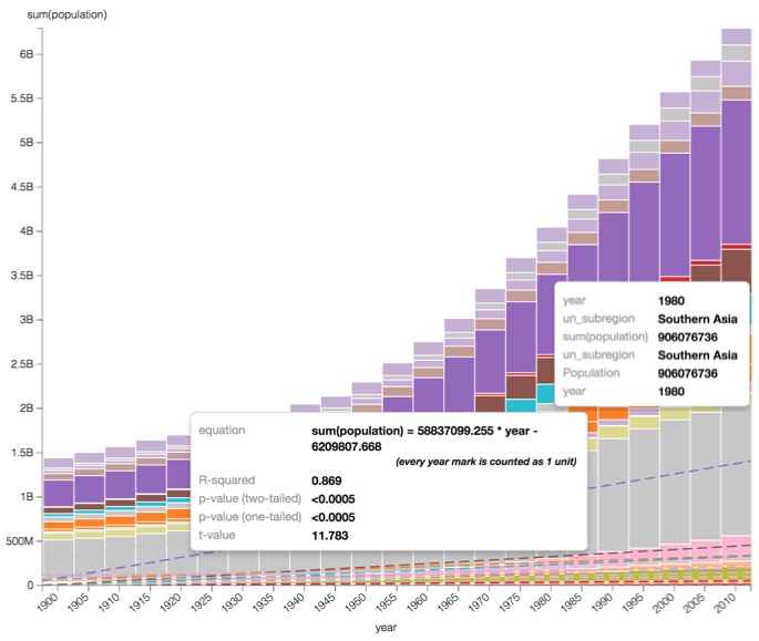

Here is a bar visual with trendlines. In the following example, notice that a linear trendline clearly shows that the population of Southern Asia has consistently risen over the years.
