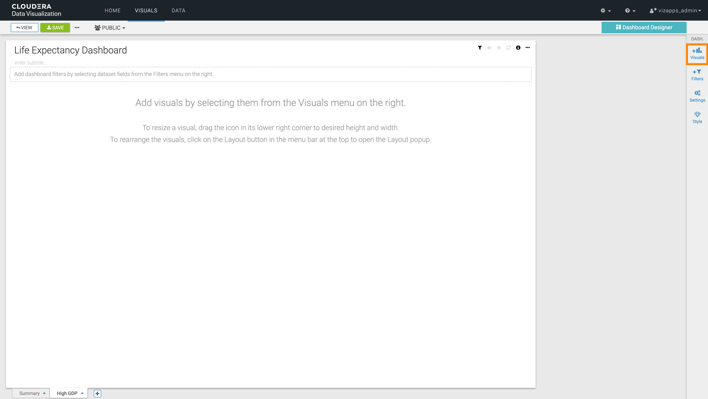

- Open a dashboard of your choice in Edit mode.
- Choose a sheet in the dashboard where you plan to add visuals.
This examples works with a sheet called High GDP.
In the Visual Builder side menu bar on the right, select
Visuals.
- In the Visuals menu, make configuration changes as you
need.
