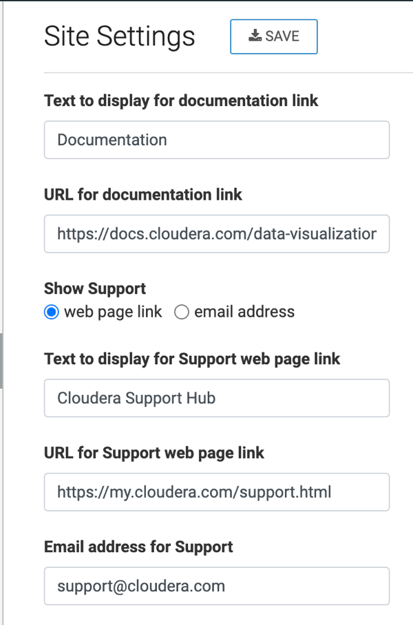

Customizing Help on the UI
You can change the default settings of the Help menu in Cloudera Data Visualization. You can customize the links for Documentation and Support on the Site Settings interface.
In , you can change the following:
