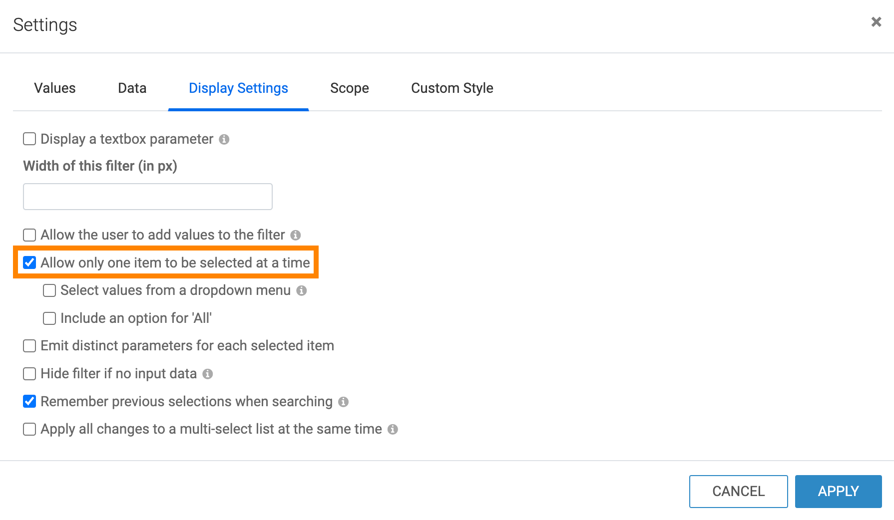

Switch to the Values tab and enter the following:
- Under Title, enter Dimension Level.
- Under Output Parameter, enter dim. Note that this is the parameter from Creating visuals with variable dimensions.
- Under Specified values, enter the following two rows:
- Value:
stname, Label: State - Value:
ctyname, Label: County
- Value:
Switch to the Display Settings tab and select the
Allow only one item to be selected option.
- Click APPLY.
