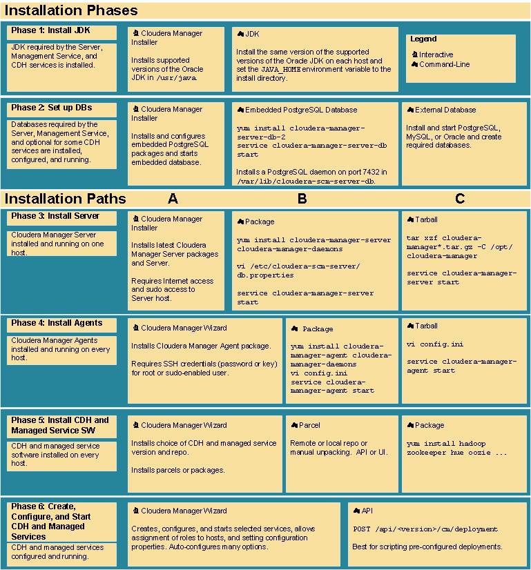

Installation Phases and Paths for Cloudera Manager, CDH, and Managed Services
The following diagram illustrates the phases required to install Cloudera Manager, CDH, and managed services. Every phase is required, but there are multiple ways to accomplish each phase, depending on your organization's policies and requirements.
The six phases are grouped into three installation paths based on how Cloudera Manager and embedded database software is installed on the Cloudera Manager Server and cluster hosts. For each path you can choose to use the embedded PostgreSQL database or an external database.
- Installation Path A - Automated Installation by Cloudera Manager - You install the JDK, Cloudera Manager Server, and embedded PostgreSQL packages using an installer binary. You optionally install an external database. Cloudera Manager Agent, CDH, and managed service installation is performed by the Cloudera Manager wizard.
- Installation Path B - Manual Installation Using Cloudera Manager Packages - You manually install the JDK, Cloudera Manager Server, Cloudera Manager Agent, and embedded PostgreSQL, and optionally CDH and managed service packages, and optionally install and configure an external database. After the Cloudera Manager Server and Agents are running, you can alternatively install CDH and managed service parcels using the Cloudera Manager wizard.
- Installation Path C - Manual Installation Using Cloudera Manager Tarballs - You manually install the JDK, Cloudera Manager Server, Cloudera Manager Agent, and embedded PostgreSQL software using tarballs, and optionally install and configure an external database. After the Cloudera Manager Server and Agents are running, you install CDH and managed service parcels using the Cloudera Manager wizard.
