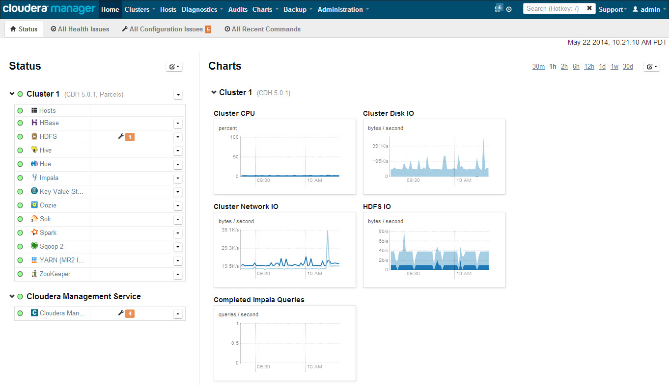

When you start the Cloudera Manager Admin Console, the Home page displays.

The default tab displayed when the Home page displays. It contains:- A summary of the clusters being managed by Cloudera Manager. To add a cluster, click
and select Add Cluster and follow the instructions in Adding and Deleting Clusters. Each cluster is represented in two panels: Status and Charts.- Status - A table containing links to the All Hosts page and the status pages of the services running in the cluster.

- Charts - A set of charts (dashboard) that summarizes cluster level resource utilization (IO, CPU usage) and processing metrics.

. Click a line, stack area, scatter, or bar chart to expand it into a full-page view with a legend for the individual charted entities as well more fine-grained axes divisions.
By default the time scale of a dashboard is 30 minutes. To change the time scale, click a duration link
at the top-right of the dashboard.
