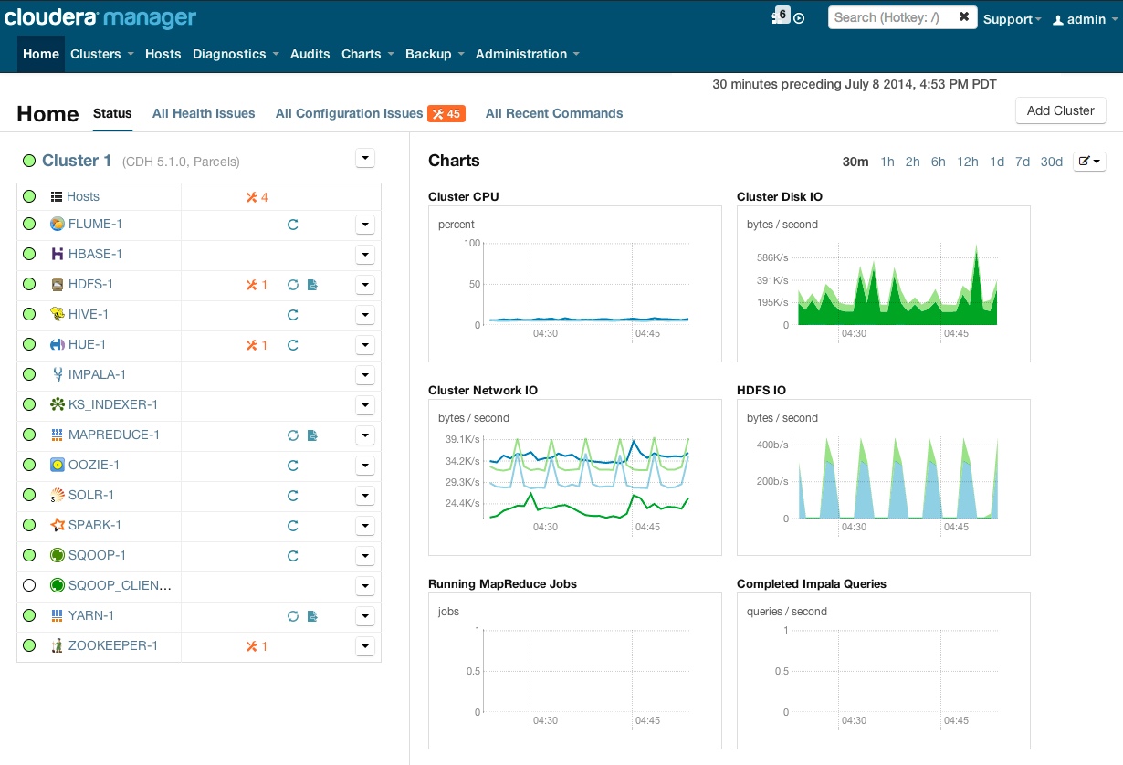

When you start the Cloudera Manager Admin Console, the Home page displays.
You can also navigate to
the Home page by clicking Home
in the top navigation bar.
Status
The default tab displayed when the Home page displays. It contains:- Clusters - The clusters being managed by Cloudera Manager. Each cluster
is displayed either in summary form or in full form depending on the
configuration of the property. When the number of clusters exceeds the value of
the property, only cluster summary information displays.
- Summary Form - A list of links to cluster status pages. Click Customize to jump to the property.
- Full Form - A
separate section for each cluster containing a link to the cluster
status page and a table
containing links to the Hosts page and the status pages of the
services running in the cluster.Each service row in the table has a menu of actions that you select by clicking
and can
contain one or more of the following indicators:
Indicator Meaning Description
Health issue Indicates that the service has at least one health issue. The indicator shows the number of health issues at the highest severity level. If there are Bad heath test results, the indicator is red. If there are no Bad health test results, but Concerning test results exist, then the indicator is yellow. No indicator is shown if there are no Bad or Concerning health test results.
Important: If there is one Bad health test result and two Concerning health results, there will be three health issues, but the number will be one.Click the indicator to display the Health Issues pop-up dialog.
By default only Bad health test results are shown in the dialog. To display Concerning health test results, click the Also show n concerning issue(s) link. Click the link to display the Status page containing with details about the health test result.
Configuration issue Indicates that the service has at least one configuration issue. The indicator shows the number of configuration issues at the highest severity level. If there are configuration errors, the indicator is red. If there are no errors but configuration warnings exist, then the indicator is yellow. No indicator is shown if there are no configuration notifications.
Important: If there is one configuration error and two configuration warnings, there will be three configuration issues, but the number will be one.Click the indicator to display the Configuration Issues pop-up dialog.
By default only notifications at the Error severity level are listed, grouped by service name are shown in the dialog. To display Warning notifications, click the Also show n warning(s) link. Click the message associated with an error or warning to be taken to the configuration property for which the notification has been issued where you can address the issue. See Managing Services.
Restart Needed
Refresh
NeededConfiguration modified Indicates that at least one of a service's roles is running with a configuration that does not match the current configuration settings in Cloudera Manager. Click the indicator to display the Stale Configurations page. To bring the cluster up-to-date, click the Refresh or Restart button on the Stale Configurations page or follow the instructions in Refreshing a Cluster, Restarting a Cluster, or Restarting Services and Instances after Configuration Changes.
Client configuration redeployment required Indicates that the client configuration for a service should be redeployed. Click the indicator to display the Stale Configurations page. To bring the cluster up-to-date, click the Deploy Client Configuration button on the Stale Configurations page or follow the instructions in Manually Redeploying Client Configuration Files.
- Cloudera Management
Service - A table containing a link to the Cloudera Manager
Service. The Cloudera Manager Service has a menu of actions that you
select by clicking
. - Charts - A set of
charts (dashboard) that summarize resource
utilization (IO, CPU usage) and processing metrics.
Click a line, stack area, scatter, or bar chart to expand it into a full-page view with a legend for the individual charted entities as well more fine-grained axes divisions.
By default the time scale of a dashboard is 30 minutes. To change the time scale, click a duration link
at the top-right of the dashboard.To set the dashboard type, click
and select one of the following:- Custom - displays the custom dashboard.
- Default - displays the default dashboard.
- Reset - resets the custom dashboard to the predefined set of charts, discarding any customizations.
